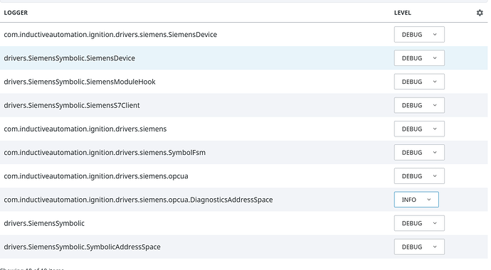

i connected the s7 1500 with ignition via s7 driver, and it’s successfully connected, So once o browsed for the tags and i am trying to write back on these tags nothing change at all. i tried to use toggle switch once i click it, it get back to its initial status.
note: This is only happens with the boolean type

Set some of the Siemens loggers to debug level, and try to write again. Then check the logs and share if there is anything relevant there.
We have boolean tags that we test against, so we'll have to figure out what is different with your tags compared to ours.
EDIT: Here's an example, leave DiagnoticsAddressSpace set to info, it will be unnecessarily noisy:
 ![image](https://us1.discourse-cdn.com/inductiveautomation/original/3X/7/d/7d32bcd84c6c2dfd53ac5540917542bb0af20561.png)

![image](https://us1.discourse-cdn.com/inductiveautomation/original/3X/2/a/2ac138fce32d7ac3ee38c30887455b54163de80c.png)that what i see in the loggers
btw, i tried to force the inputs in tia portal and i can see the designer read it properly but when i try to write from designer, it doesn’t work
**Post date:** [September 5, 2025, 7:22pm UTC](https://forum.inductiveautomation.com/t/s7-1500-tags-writing-issue/110416/11 "2025-09-05T19:22:54Z")
I’d expect inputs are read only to external clients and the driver should respond with a bad status.
**Author:** ![ahmedsaeeed907](https://avatars.discourse-cdn.com/v4/letter/a/fbc32d/32.png) [@ahmedsaeeed907](https://forum.inductiveautomation.com/u/ahmedsaeeed907)\
**Post date:** [September 5, 2025, 7:31pm UTC](https://forum.inductiveautomation.com/t/s7-1500-tags-writing-issue/110416/12 "2025-09-05T19:31:00Z")
kindly can you clarify this more becuase i couldn’t get how can i find these configs that will change that
**Post date:** [September 5, 2025, 7:37pm UTC](https://forum.inductiveautomation.com/t/s7-1500-tags-writing-issue/110416/13 "2025-09-05T19:37:20Z")
Most platforms do not allow "setting" the signals from physical inputs. You have to **force** them, which is usually available only in a programming tool like TIA Portal.

In Tia Portal i make the full access for the external Clients and i even checked PUT/GET
When i access the DataBlock whatever boolean or integer value, it works properly
**Post date:** [September 5, 2025, 7:42pm UTC](https://forum.inductiveautomation.com/t/s7-1500-tags-writing-issue/110416/15 "2025-09-05T19:42:57Z")
If these aren't physical inputs, but are ordinary bits in a datablock's structure, then my comment wouldn't apply. ~~Seems like bug.~~

The Issue here is about the Physical Inputs Of The PLC itself, not the datablock
**Post date:** [September 5, 2025, 7:45pm UTC](https://forum.inductiveautomation.com/t/s7-1500-tags-writing-issue/110416/17 "2025-09-05T19:45:37Z")
You can't write to physical inputs.
**Post date:** [September 5, 2025, 7:45pm UTC](https://forum.inductiveautomation.com/t/s7-1500-tags-writing-issue/110416/18 "2025-09-05T19:45:43Z")
Then you should not expect to be able to write to those.
**Post date:** [September 5, 2025, 7:48pm UTC](https://forum.inductiveautomation.com/t/s7-1500-tags-writing-issue/110416/19 "2025-09-05T19:48:56Z")
Yeah omg that’s right, I think i lost my mind though while i am trying to change the physical Inputs
really thankful for your time
