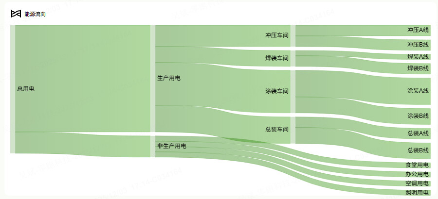

May I ask if there is a solution for Sankey diagrams in the current version 8.3？

If you have webdev module licensed in your gateway you can bring sankey chart js code via iframe in your project and pass chart data in URL parameters.
**Author:** ![bmusson](https://sea1.discourse-cdn.com/inductiveautomation/user_avatar/forum.inductiveautomation.com/bmusson/32/87530_2.png) [@bmusson](https://forum.inductiveautomation.com/u/bmusson)\
**Post date:** [December 2, 2025, 4:02pm UTC](https://forum.inductiveautomation.com/t/sankey-in-version-8-3/112554/7 "2025-12-02T16:02:18Z")
Embr Chart’s Chart.js component includes this Sankey diagram plugin:
> **[GitHub - kurkle/chartjs-chart-sankey: Chart.js module for creating sankey diagrams](https://github.com/kurkle/chartjs-chart-sankey)**
**Author:** ![Senthee\_Wu](https://sea1.discourse-cdn.com/inductiveautomation/user_avatar/forum.inductiveautomation.com/senthee_wu/32/67770_2.png) [@Senthee\_Wu](https://forum.inductiveautomation.com/u/Senthee_Wu)\
**Post date:** [December 3, 2025, 9:19am UTC](https://forum.inductiveautomation.com/t/sankey-in-version-8-3/112554/8 "2025-12-03T09:19:04Z")
![image](https://us1.discourse-cdn.com/inductiveautomation/original/3X/1/f/1fb443a2be9844aa2d8123db53f8504502886a98.jpeg)

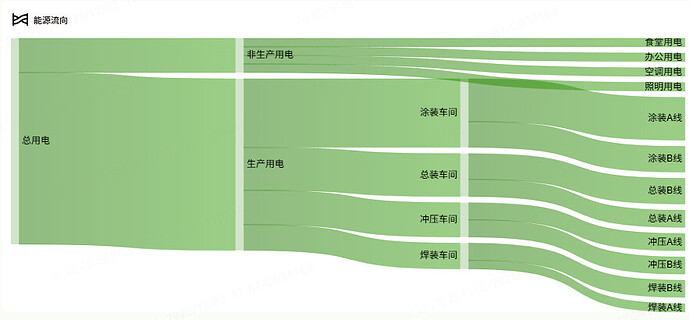

Thank you very much. I didn't realize that Sankey diagrams were supported until I clicked on the Chart.js section for types. I successfully created an energy flow chart and would like to ask an additional question: do you know which parameter can sort the data in the order of 'data'? In ECharts.js, I found a property parameter 'layoutIterations=0', but it didn't work. I added labels, and somehow by chance, it succeeded (in Figure 2, it changed to the order of my 'data'). Do you know why this happened or if there is a better approach?
**Post date:** [December 3, 2025, 3:35pm UTC](https://forum.inductiveautomation.com/t/sankey-in-version-8-3/112554/9 "2025-12-03T15:35:10Z")
I don’t have time to test anything, but according to the documentation you can set a `priority` property to control the order of the nodes.
