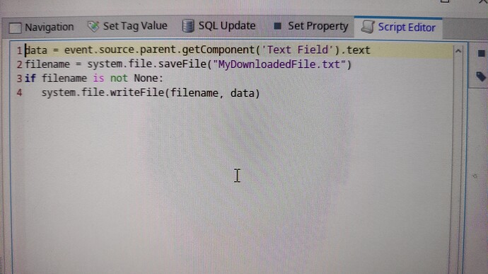

Good day!
I’ve just upgraded from Ignition 7 to Ignition 8 and migrated a project also. There were some issues on the migration but I got some of them fixed but this bug I haven’t fixed. Saving a csv with an automated filename.
This is my project from Ignition 7.
 ![IMG_20190614_085402](https://us1.discourse-cdn.com/inductiveautomation/original/2X/1/1e912db0c5cd56710ad978dbdfa8c051e14624fd.jpeg)
 ![IMG_20190614_085459](https://us1.discourse-cdn.com/inductiveautomation/original/2X/5/594da69523ee533a03a279e919d2082d24250d96.jpeg)
and here is the project migrated to Ignition 8.
 ![IMG_20190614_085622](https://us1.discourse-cdn.com/inductiveautomation/original/2X/1/178a4a05bed6b4eafd912a4dfb0f889eedd30151.jpeg)
 ![IMG_20190614_085705](https://us1.discourse-cdn.com/inductiveautomation/original/2X/9/9f4e60cacfc75e19c2bcaf60a96fb98510a6640f.jpeg)
and also I created a new project still had the same result
 ![IMG_20190614_091006](https://us1.discourse-cdn.com/inductiveautomation/original/2X/5/5a9df90d35021fd0de5bc01e2221d70559a6706b.jpeg)
 ![IMG_20190614_091025](https://us1.discourse-cdn.com/inductiveautomation/original/2X/6/62c4e8133504b34587b618ade2ec73a1b7442b44.jpeg)
I did this kind of automated filename for the different data to be extracted with the automated date. It is a hassle to always type the filename. Is there a solution for this?
Thanks!

I think its related to another bug that is being worked on unfortunately. I'd keep an eye on the linked thread for updates.
> [@\[Bug-11875\] system.dataset.exportCSV not creating csv](http://forum.inductiveautomation.com/t/bug-11875-system-dataset-exportcsv-not-creating-csv/21123):
> I don’t believe you had to include a file extension in the filename for 7.9 when using this function. The save prompt would open with file extension type .csv and you’d type a name and it would add the .csv extension to the filename when saving whether you typed it in or not. In 8.0 it doesn’t do that, you have to add a .csv at the end of the filename or it will save the file without extension. Another thing I’m seeing is that the save prompt doesn’t pre-populate with a suggested filename whe…
