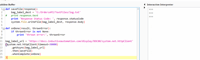

**Author:** ![MikeAllgood](https://avatars.discourse-cdn.com/v4/letter/m/a183cd/32.png) [@MikeAllgood](https://forum.inductiveautomation.com/u/MikeAllgood)\
**Post date:** [March 9, 2021, 8:14pm UTC](https://forum.inductiveautomation.com/t/saving-a-file-to-local-path-from-an-amazon-s3-bucket-via-url/38843/12 "2021-03-09T20:14:04Z")
In my Script Console that is still not printing any information to the output window.
 ![ScriptConsoleTestResults](https://us1.discourse-cdn.com/inductiveautomation/original/3X/3/2/32e93de47f9821bb436cfc0ecff70d250827ed12.png)
Is there a “dummies” guide, online preferably, to these objects/methods that you could recommend?
My lack of understanding what is going on here is a big issue. The java and python docs don’t do me any favors as they are written, in my opinion, like I should already know a lot about what they are referring to. And I know zilch!
On a slightly different front, the original code that I had working as part of the doPost script in the Web Dev endpoint is getting moved a bit. We’ve found that the level of data that the customer is needing to send to the system is causing slowdowns. So we are moving the downloading of the images to GW Timed Event and letting that process a handful of images at a time. When I test this on a single image download it times out (here the timeout is one of my making so I can validate the image was downloaded and update the database accordingly). I can manually download the file by pasting the URL into a browser, so I’m, again, not understanding what is happening to prevent the download.
The code I’m using looks like this:

> [@MikeAllgood](#):
Yes - that's expected. The script console will only capture 'direct' output - because you're invoking your request asynchronously, it's "leaving" the context of the script console and going to the general output console - where you should see output.
> [@MikeAllgood](#):
Unfortunately not. The `Promise` object is largely inspired by Javascript's `Promise` object, but under the hood is really just a Java `CompletableFuture`... and, honestly, if `Promise` is a moderately confusing API, `CompletableFuture` is the Necronomicon.
> [@MikeAllgood](#):
You mentioned you're downloading these images from S3 - Ignition might not be providing the right authentication (likely via a cookie) to authenticate with S3, so S3 is just refusing to give any indication that the URL is valid at all. Can you still download if you try a URL in an incognito/private session in the browser?
Also, I'm not really sure what your goal is with the while loop in your latest example. If you want to 'block' the rest of the script from executing until the file is downloaded, just avoid the async call entirely and call `httpClient.get()` - then you're guaranteed to have a `Response` that you know is valid (or not) before script execution continues. Or, if you _do_ want to use async, fully use async; starting an async task and then blocking to wait for it immediately after is somewhat pointless.
A more idiomatic thing to do would be to `get()` on the promise, if you had some intermediate work to do:
```auto
def downloadImage(response):
	util.log(ln, 'In downloadImage function.')
	system.file.writeFile(bag_label_dest, response.body)
	return "File written"
client = system.net.httpClient(timeout=30000) # 30s timeout for the actual HTTP connection
promise = client.getAsync(bag_label_url).then(downloadImage)
util.log(ln, 'created promise object')
# do some intermediate task
output = promise.get(timeout=30000) # additional 30s for the second stage to complete
# output == 'File written'
