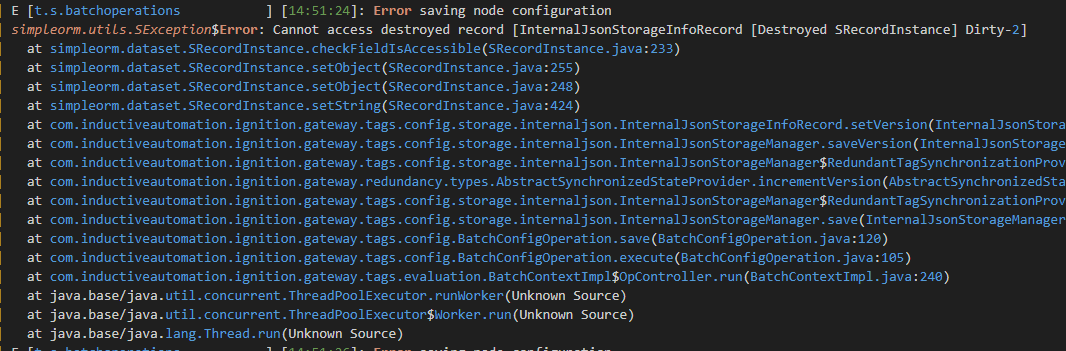

Hi all,
I'm on Ignition 8.1.25 and I'm getting the following annoying Exception again:
 ![image](https://us1.discourse-cdn.com/inductiveautomation/original/3X/1/4/14c2f7a460f47c2e928512e5348e8378116c9e13.png)
That's filling up my _wrapper.log_, so that it is quite useless as a debug tool.
Any suggestion?
**Post date:** [November 30, 2023, 4:02pm UTC](https://forum.inductiveautomation.com/t/saving-node-configuration-error/82540/2 "2023-11-30T16:02:50Z")
Support?
Do you have a script running `system.tag.configure` ?
**Post date:** [November 30, 2023, 4:08pm UTC](https://forum.inductiveautomation.com/t/saving-node-configuration-error/82540/3 "2023-11-30T16:08:57Z")
Upgrade. I'm pretty sure we already fixed this bug.
