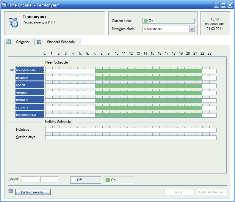

Hi all,
I’m preparing to design “Scheduler” window. This has able to view/edit week scheduler for “4 state” tag (comfort, eco, support, stand-by). Week scheduler is holding at PLC.
Does any body do scheduler window before, or can give couple advise how to do it more user-friendly?

**Author:** ![andrey](https://avatars.discourse-cdn.com/v4/letter/a/73ab20/32.png) [@andrey](https://forum.inductiveautomation.com/u/andrey)\
**Post date:** [March 21, 2011, 2:16pm UTC](https://forum.inductiveautomation.com/t/scheduler-window/2638/5 "2011-03-21T14:16:27Z")
[quote=“Carl.Gould”]Could you just stack 4 buttons/rectangles per day? And then bind each one’s background color to an expression that either filled it in or not based upon the chosen value for the day?[/quote]Each day can have up to 10 points, where workmode changes it’s state. How can I change a time period for each state?
Below is a screenshot of scheduler window, where I can change the time period. But this window was designed for two-state tag (on/off). Maybe someone have already designed something similar or know how to use relative timescale (only for week).

**Author:** ![Carl.Gould](https://sea1.discourse-cdn.com/inductiveautomation/user_avatar/forum.inductiveautomation.com/carl.gould/32/7262_2.png) [@Carl.Gould](https://forum.inductiveautomation.com/u/Carl.Gould)\
**Post date:** [March 30, 2011, 8:06pm UTC](https://forum.inductiveautomation.com/t/scheduler-window/2638/6 "2011-03-30T20:06:09Z")
I don’t totally understanding what you’re asking for, but I played around with some ideas that might help you.
Here’s a window with a container on it that would represent a day, where you can manipulate the start, stop, and mode for the day. It’s not drag-able, but it does work. You’d bind the start, stop, and mode controls to your PLC values.
Upgrade to 7.2.5 first - there was a bug with the level indicator in horizontal mode that will make this not work in earlier versions.
Hope this helps,
[scheduling.vwin](https://us1.discourse-cdn.com/inductiveautomation/original/1X/7562407c7afde3b9fd07cb2767981fc2a00a8bb6.vwin) (15.4 KB)
 ![](https://us1.discourse-cdn.com/inductiveautomation/original/1X/792ce81e23987283390505252b8068720c793d01.PNG)
**Author:** ![Brett\_Yeomans](https://avatars.discourse-cdn.com/v4/letter/b/35a633/32.png) [@Brett\_Yeomans](https://forum.inductiveautomation.com/u/Brett_Yeomans)\
**Post date:** [August 24, 2011, 2:41pm UTC](https://forum.inductiveautomation.com/t/scheduler-window/2638/7 "2011-08-24T14:41:07Z")
I am trying to create a similar scheduler and i’m trying to use the level indicator but the component “fill” is anchored to one end, how do you get the value to fill from both ends? I cannot see any mention of horizontal mode only fill from left to right etc?
**Author:** ![Travis.Cox](https://avatars.discourse-cdn.com/v4/letter/t/b9bd4f/32.png) [@Travis.Cox](https://forum.inductiveautomation.com/u/Travis.Cox)\
**Post date:** [August 24, 2011, 3:07pm UTC](https://forum.inductiveautomation.com/t/scheduler-window/2638/8 "2011-08-24T15:07:11Z")
The level indicator component has a property called Orientation which you can set to Left to Right. That will make it fill in from the left. Is that what you are looking for?
**Post date:** [August 24, 2011, 6:19pm UTC](https://forum.inductiveautomation.com/t/scheduler-window/2638/9 "2011-08-24T18:19:21Z")
Not really, if I select left to right it fills anchored from the left side but in the example screen the filled in data is like starting at 25% and ending at 75%, I can only get it to fill 0% to 75% not have the filled in data away from 0% if you see what I mean, and I want it represent an ON time as well as an OFF time like in the example.
**Post date:** [August 24, 2011, 7:50pm UTC](https://forum.inductiveautomation.com/t/scheduler-window/2638/10 "2011-08-24T19:50:13Z")
My bad, did’nt notice the vwin attachment, now understand the second level indicator(“start mask)” that sits on top of the first that fills in (mask’s) the left hand side with white.
**Post date:** [September 8, 2011, 6:31pm UTC](https://forum.inductiveautomation.com/t/scheduler-window/2638/11 "2011-09-08T18:31:12Z")
Right, it takes two components to create that effect.
