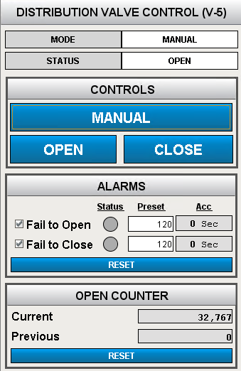

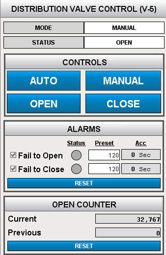

I am having some difficulty pushing out screen changes across two clients.
Changes made on the Ignition Designer are not showing up on my first client but are showing up on my second client.
I have tried the following on first client:
- Restarting
- Re-Downloading and Launching the project from the web interface.
I am using globe scripts but i awes push out the globe updates along with the project updates.
An help would be appreciated - Thanks in advance
P.S. I am on 7.9.3

**Post date:** [August 13, 2018, 5:53pm UTC](https://forum.inductiveautomation.com/t/screen-changes-not-consistent-across-two-clients/19228/3 "2018-08-13T17:53:13Z")
try a fresh download. Just downloading from the gateway homepage doesn’t mean the cache is any good. Since it appears you are using Java webstart:
- delete jws cache:
**javaws.exe -uninstall**
- delete **user\.igntion** folder
And, of course, consider using the Native Client Launcher instead of Java webstart.

There are component changes as well as script changes.
I am using fixed window layouts and i replaced the component in question so I don’t think it’s a layout issue.
I attached a pic of one of the differences on client vs client 2.
Client 2 (New layout)
 ![](https://us1.discourse-cdn.com/inductiveautomation/original/2X/8/873c3828ccf97ceb05eb132f7dec484a770edee4.png)
Client 1 (Old layout)
 ![](https://us1.discourse-cdn.com/inductiveautomation/original/2X/c/cd19885faa8d98d38d5af5d7fbb39d68a40fc716.png)
**Author:** ![PearceJ](https://avatars.discourse-cdn.com/v4/letter/p/edb3f5/32.png) [@PearceJ](https://forum.inductiveautomation.com/u/PearceJ)\
**Post date:** [August 13, 2018, 7:08pm UTC](https://forum.inductiveautomation.com/t/screen-changes-not-consistent-across-two-clients/19228/5 "2018-08-13T19:08:45Z")
This fixed my issue
Thanks
