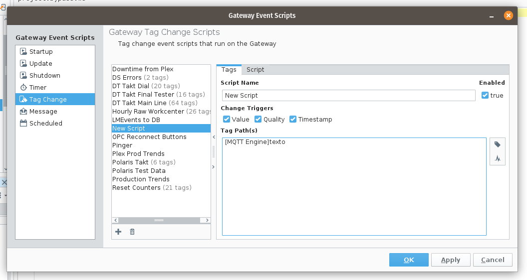

Hi,
I receive via mqtt a large string with the value of my tags and I'm separating it by ";" so I made a script to separate the values of this string.
```python
tag_path = ("[MQTT Engine]texto")
tag_value = system.tag.read(tag_path).value.split("; ")
print tag_value [2]
Up to this point, we're OK, it's working properly and I can see it from the console output. My question is how can I take this value that comes out of my script and assign it to a Tag?

**Post date:** [July 15, 2025, 7:19pm UTC](https://forum.inductiveautomation.com/t/script-in-the-tag/108519/3 "2025-07-15T19:19:41Z")
It's tempting to put it in a script within the tag, but do it in a [Gateway Tag Change script,](https://www.docs.inductiveautomation.com/docs/8.1/platform/scripting/scripting-in-ignition/gateway-event-scripts#tag-change-scripts) instead.
```python
tag_value = event.currentValue.value.split('; ')
system.tag.writeAsync(['[default]path/to/my/tag'], [tag_value[2]])
 ![image](https://us1.discourse-cdn.com/inductiveautomation/original/3X/5/8/58ed27f850f0e9635497fcd3ad0046fec5301409.png)
 ![image](https://us1.discourse-cdn.com/inductiveautomation/original/3X/e/4/e4763fb854d59f7355c5a99486dd953d8bb94ef7.png)

Thanks guys!
With the (system.tag.writeAsync or writeBlocking) I managed to write in my tags, in the Gateway tag change script I had to make changes, but I managed to leave it even better than I thought. Thanks a lot guys!
