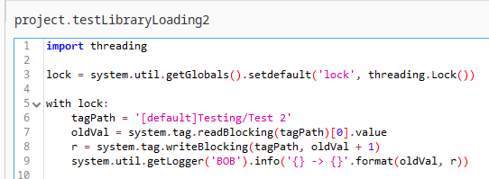

It seems to have to do with the GSP, but I would have expected a change to an inherited script library would reload it in all inherting projects which would then run it and therefore write to the tag in all locations. I added a lock to get rid of the race condition where two threads could read the current tag value at the same time and hence increment by 1 always instead of 2:
 ![image](https://us1.discourse-cdn.com/inductiveautomation/original/3X/e/e/ee34d13fc5211c91e69be942168546f66445524a.png)

**Post date:** [November 6, 2025, 12:34am UTC](https://forum.inductiveautomation.com/t/script-library-reloading-and-project-inheritance/111978/5 "2025-11-06T00:34:07Z")
Would this not fix the raceyness with tags?
 ![image](https://us1.discourse-cdn.com/inductiveautomation/original/3X/2/3/2380571d6d0bed57691a2fb4c4a3dd134dfc273a.png)
**Post date:** [November 6, 2025, 1:02am UTC](https://forum.inductiveautomation.com/t/script-library-reloading-and-project-inheritance/111978/6 "2025-11-06T01:02:58Z")
Yes, until some other programmer stomps on your too-common name. (One of the reasons `system.util.globalVarMap()` takes a namespace argument.)
