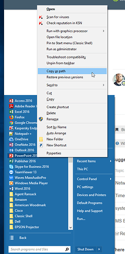

**Author:** ![ngadow](https://avatars.discourse-cdn.com/v4/letter/n/22d042/32.png) [@ngadow](https://forum.inductiveautomation.com/u/ngadow)\
**Post date:** [October 25, 2018, 8:40pm UTC](https://forum.inductiveautomation.com/t/scripting-error-when-trying-to-link-out-to-power-point/20383/3 "2018-10-25T20:40:06Z")
I don’t really know. I’ve always done the shift+right click and use the Copy as path - then the same for where my document is.
 ![](https://us1.discourse-cdn.com/inductiveautomation/original/2X/1/1ea3a2b273c33e76700264d4af84c86094d84692.png)
**Author:** ![ethomason](https://sea1.discourse-cdn.com/inductiveautomation/user_avatar/forum.inductiveautomation.com/ethomason/32/43338_2.png) [@ethomason](https://forum.inductiveautomation.com/u/ethomason)\
**Post date:** [October 25, 2018, 8:43pm UTC](https://forum.inductiveautomation.com/t/scripting-error-when-trying-to-link-out-to-power-point/20383/4 "2018-10-25T20:43:42Z")
Navigate to C:\ProgramData\Microsoft\Windows\Start Menu\Programs\ in Explorer, find the .lnk file, right click and go to Properties, and find Target. It’ll be a .exe file. Use that path in system.util.execute instead of C:\ProgramData\Microsoft\Windows\Start Menu\Programs\Word 2016.lnk
![](https://us1.discourse-cdn.com/inductiveautomation/original/2X/a/a2a2e629e6bc8e16aa88932727f05b776ad3f9ec.png)
**Post date:** [October 25, 2018, 8:58pm UTC](https://forum.inductiveautomation.com/t/scripting-error-when-trying-to-link-out-to-power-point/20383/5 "2018-10-25T20:58:43Z")
Yep - I finally dug around until I found the actual exe for PowerPoint - It’s working now - thanks!!
“C:\Program Files\Microsoft Office\Office16\POWERPNT.EXE”
