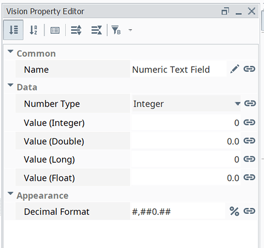

I am doing a simple experiment on a Numeric Text Field :
```auto
if event.propertyName == "intValue":
	print event.newValue
on propertyChange Event Handlers
but print nothing
I print event.propertyName but never shows the value "intValue".
shows "editValid".
If I change the code to
```auto
if event.propertyName == "editValid":
only prints False or True but not the value.
Pls your help.
**Post date:** [October 23, 2023, 3:53pm UTC](https://forum.inductiveautomation.com/t/scripting-help-about-just-simple-print-a-value-on-propertychange-on-a-numerictext-field/80864/2 "2023-10-23T15:53:47Z")
Is the numeric input field set to use integers? It can also be set to Long, Float, and Double, and if so, `intValue` is not used.
**Author:** ![Gustavo\_Rojas](https://avatars.discourse-cdn.com/v4/letter/g/46a35a/32.png) [@Gustavo\_Rojas](https://forum.inductiveautomation.com/u/Gustavo_Rojas)\
**Post date:** [October 23, 2023, 3:57pm UTC](https://forum.inductiveautomation.com/t/scripting-help-about-just-simple-print-a-value-on-propertychange-on-a-numerictext-field/80864/3 "2023-10-23T15:57:38Z")
![image](https://us1.discourse-cdn.com/inductiveautomation/original/3X/e/a/ea6a50738d742314b5090386ad522f39f7e4f403.png)
Yes is set on that way

I am figuring out how to do the "What if you set the property filter to 'All' and change the value of the 'Defer Updates' boolean property?" part.
**Post date:** [October 23, 2023, 7:03pm UTC](https://forum.inductiveautomation.com/t/scripting-help-about-just-simple-print-a-value-on-propertychange-on-a-numerictext-field/80864/17 "2023-10-23T19:03:02Z")
Sorry for the question
How do this?
> [@Gustavo\_Rojas](#):
**Author:** ![leonardo.godoi](https://sea1.discourse-cdn.com/inductiveautomation/user_avatar/forum.inductiveautomation.com/leonardo.godoi/32/27178_2.png) [@leonardo.godoi](https://forum.inductiveautomation.com/u/leonardo.godoi)\
**Post date:** [October 23, 2023, 7:04pm UTC](https://forum.inductiveautomation.com/t/scripting-help-about-just-simple-print-a-value-on-propertychange-on-a-numerictext-field/80864/18 "2023-10-23T19:04:18Z")
Like this @Gustavo_Rojas :
 ![java_bOzCTE8hOu](https://us1.discourse-cdn.com/inductiveautomation/original/3X/3/d/3dd2026528a241ed7e9e1a66c0bc54048ea5636e.gif)
**Post date:** [October 23, 2023, 7:05pm UTC](https://forum.inductiveautomation.com/t/scripting-help-about-just-simple-print-a-value-on-propertychange-on-a-numerictext-field/80864/19 "2023-10-23T19:05:12Z")
@leonardo.godoi Thank you
**Post date:** [October 23, 2023, 7:07pm UTC](https://forum.inductiveautomation.com/t/scripting-help-about-just-simple-print-a-value-on-propertychange-on-a-numerictext-field/80864/20 "2023-10-23T19:07:18Z")
@leonardo.godoi and @paul-griffith Thank you now works . I learn a lot .
