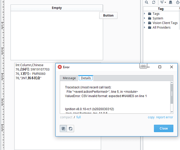

**Author:** ![yifeiliu08](https://avatars.discourse-cdn.com/v4/letter/y/bbe5ce/32.png) [@yifeiliu08](https://forum.inductiveautomation.com/u/yifeiliu08)\
**Post date:** [April 30, 2020, 3:48pm UTC](https://forum.inductiveautomation.com/t/scripting-the-message-to-different-line-and-show-in-ignition/34295/7 "2020-04-30T15:48:08Z")
![image](https://us1.discourse-cdn.com/inductiveautomation/original/2X/3/309a5a7795c558ca5b9cdb77c69e4249148fd416.png)
I following the manual
path = system.file.openFile(“CSV”)
if path != None:
contents = system.file.readFileAsString(path)
event.source.parent.getComponent(‘Text Area’).text= contents
these four line , i can see the text Area is showing Chinese
After step 1 success, i follow step 2
 ![image](https://us1.discourse-cdn.com/inductiveautomation/original/2X/2/2916d1235bba05745360d9359c0ce5fbb6d9100c.png)
data = system.dataset.fromCSV(event.source.parent.getComponent(‘Text Area’).text)
event.source.parent.getComponent(‘Power Table’).data=data
 ![image](https://us1.discourse-cdn.com/inductiveautomation/original/2X/5/5da8e02fa64c3ef540417851ec64404a4689132d.png)
![image](https://us1.discourse-cdn.com/inductiveautomation/original/2X/7/79e80fe382d6b8dd7dea4dd11bd8be4707dabb49.png)
i suppose the red line high light is the Name
**Post date:** [April 30, 2020, 4:04pm UTC](https://forum.inductiveautomation.com/t/scripting-the-message-to-different-line-and-show-in-ignition/34295/8 "2020-04-30T16:04:37Z")
> [@pturmel](#):
> If you can restructure your CSV file slightly to follow Ignition’s dataset import/export format, I would expect that to handle the characters correctly. Use [system.file.readFileAsString()](https://docs.inductiveautomation.com/display/DOC79/system.file.readFileAsString) with utf-8, then use [system.dataset.fromCSV()](https://docs.inductiveautomation.com/display/DOC79/system.dataset.fromCSV) to yield the dataset.
@yifeiliu08 You didn't do that. There is extra data at the top that needs to exist in order to use [system.dataet.fromCSV()](https://docs.inductiveautomation.com/display/DOC80/system.dataset.fromCSV).
**Post date:** [May 1, 2020, 1:53pm UTC](https://forum.inductiveautomation.com/t/scripting-the-message-to-different-line-and-show-in-ignition/34295/9 "2020-05-01T13:53:38Z")
![image](https://us1.discourse-cdn.com/inductiveautomation/original/2X/9/9a3adf991f37829428736f25eca48329f6dd0b5e.png)
I Follow the manual instruction, create a csv document, you can see the upside picture
when i use notepad open, it will have the same structure as manual
 ![image](https://us1.discourse-cdn.com/inductiveautomation/original/2X/4/4c27f9479157a328ac9d73eaf2f936cacd3c74d2.png)
then i scripting
 ![image](https://us1.discourse-cdn.com/inductiveautomation/original/2X/4/4e0653e6d31dd33a2eee04d0e643a49cf69ef89c.png)
 ![image](https://us1.discourse-cdn.com/inductiveautomation/original/2X/1/14ed254ab635094c231b03b8cb0c8b8560f3a543.png)
it still fault, expected names on line 1, i am confused , it seems my csv document totally the same as the manual , why still report fault ?
**Post date:** [May 1, 2020, 2:14pm UTC](https://forum.inductiveautomation.com/t/scripting-the-message-to-different-line-and-show-in-ignition/34295/10 "2020-05-01T14:14:23Z")
post your csv file here. I suspect there are extra characters in there.
**Post date:** [May 1, 2020, 2:17pm UTC](https://forum.inductiveautomation.com/t/scripting-the-message-to-different-line-and-show-in-ignition/34295/11 "2020-05-01T14:17:57Z")
yes, you are right, when i copy and paste again , it works, thanks a lot
