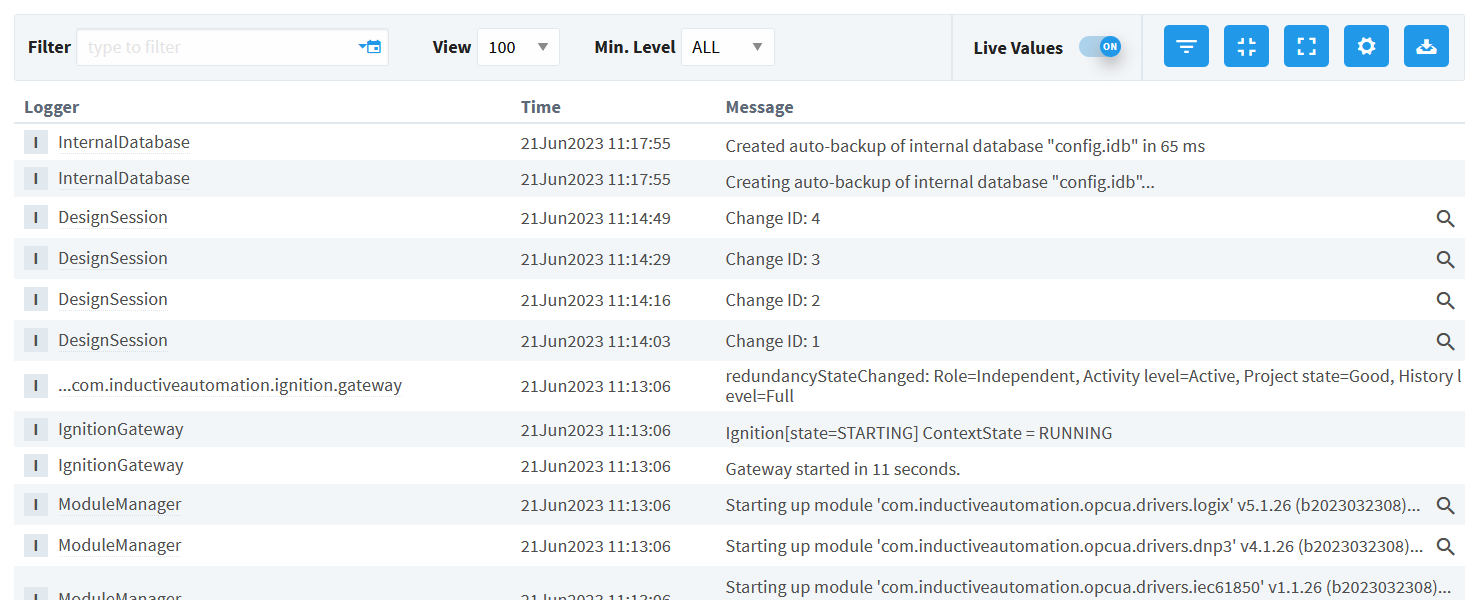

there is nothing obvious in Log:
 ![logs](https://us1.discourse-cdn.com/inductiveautomation/original/3X/a/7/a7944a304d1edfa5d9f09429697ae0294a282279.png)
**Post date:** [June 21, 2023, 6:22pm UTC](https://forum.inductiveautomation.com/t/sdk-programmers-guide-for-perspective-component-development/75321/6 "2023-06-21T18:22:24Z")
How about in the output console, in the designer? That's a "frontend" error in your component code, so the gateway log won't have anything.
