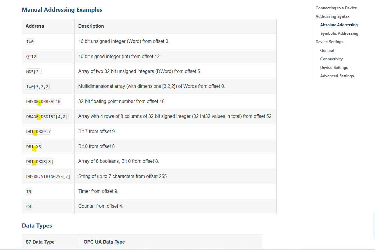

Hi folks,
I am trying to establish a tag connection to access some data within a S7- 300 DB, and no success in getting it to work. It seems none of the syntax listed in the document here ([Siemens Enhanced Driver | Ignition User Manual](https://docs.inductiveautomation.com/docs/8.3/ignition-modules/opc-ua/opc-ua-drivers/siemens/siemens-enhanced-driver)) would never work for me… e.g. DB202.DBX24, DB202.X24.0, DB202.24, DB202.DBREAL24.
Anybody has some insight to share? Would appreciate your help and thanks in advance.

This isn't the syntax described in the manual... this is: `DB202,X24.0`
Have you just got the wrong syntax or have you actually tried that as well?

Thanks Kevin for your quick response.
I tested both cases, i.e. with a period sign AND with a comma as the separator as you mentioned here. Unfortunately, the results are the same. The diagnostics message is here: Error("CreateMonitoredItems failed: Bad\_NodeIdUnknown: The node id refers to a node that does not exist in the server address space.")
FYI, accessing to the input and output points in the same PLC works fine.

![image](https://us1.discourse-cdn.com/inductiveautomation/original/3X/d/a/da51d8bf52caf3e9d85783076642e6cf3cc06ba0.png)
I made a screen shot of the manual page fyi.

Ah, are you actually using the new Siemens Enhanced driver, or the old one?

Hi Kevin, I’ve used the new one, rev 8.3. Figured out that the appropriate syntax should be DB202, REAL24. Tested ok. Thank you again for your help. Have a great weekend.

The syntaxes with the period should work with the Siemens Enhanced Driver. Are you sure you are not using the S7-300 driver?

Thanks Cody for pointing out. I forgot to mention that both the separators in my case all work well as I tested.

I have used the advanced driver .

Awesome. The Siemens Enhanced Driver was written to allow either the syntax of the older drivers, or the newer syntax that more closely matches what you would see in TIA.
