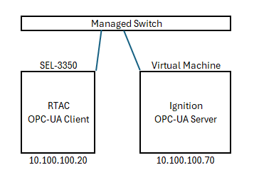

I am trying to use the OPC-UA client from an RTAC (SEL-3350) to communicate with an Ignition OPC-UA server on a virtual machine. I am having issues getting the two to connect. Has anyone connected to Ignition using the RTAC OPC-UA Client and if so, how did you get it to work?
Connection
 ![Network](https://us1.discourse-cdn.com/inductiveautomation/original/3X/4/0/401a77c51dc00a809abe195991d84ec22d79fe8d.png)
The 0 is there in the IP Address just out of view.
 ![Ignition OPC-UA Settings](https://us1.discourse-cdn.com/inductiveautomation/original/3X/b/1/b1ceee156fe88873543d69a82afd0aebb3129114.png)
Things I have Tried:
1. Toggling the Anonymous Access Allowed checkbox.
2. opc.tcp://10.100.100.70:62541/discovery in the RTAC
3. opc.tcp://10.100.100.70:62541 in the RTAC
4. Added the IP Address to the Endpoint addresses.
5. Looked at Windows Firewall settings.
System:
- Operating system: Windows Server 2022
- Ignition version: IgnitionEdge 8.1.44

Set the Bind Address to `0.0.0.0` and restart. You might also want to add the "None" SecurityPolicy while you're at it, e.g. `None, Basic256Sha256`. Turn on the "Exposed Tags" setting if you want other clients to be able to see your Ignition Tags and not just your configured devices.
Changes to these settings need a restart to take effect.

Changing the Bind Address to 0.0.0.0 and the security policy to None allow the RTAC to start importing data but the Ignition server faulted during the process.
The error message I am getting now is listed below.

**Post date:** [March 7, 2025, 10:53pm UTC](https://forum.inductiveautomation.com/t/sel-rtac-to-ignition-opc-ua-server/103346/18 "2025-03-07T22:53:36Z")
This certificate is missing some things that would make it a valid OPC UA application instance certificate. See [UA Part 6: Mappings - 6.2.2 Application Instance Certificate](https://reference.opcfoundation.org/Core/Part6/v105/docs/6.2.2);
- KeyUsage is missing `keyCertSign`
- BasicConstraints is missing entirely
 ![image](https://us1.discourse-cdn.com/inductiveautomation/original/3X/c/6/c6f57c353acbc33f30f3a81e22ab5d5592084e26.jpeg)
Do you have any control over the generation of this certificate? You may need support from SEL.
You might also be able to enable the "None" security policy and allow anonymous identities on the Ignition server and connect without security for now.
