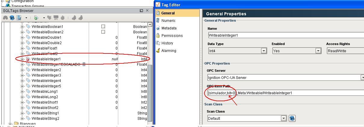

In the Ignition\_Training\_Session\_3 minute 56:02 there is a visualization of the bit 0 of an integer. I have tried to do the same procedure but it doesn’t work. Please, I need your help to continue with my training. You will find an image attached.
 ![](https://us1.discourse-cdn.com/inductiveautomation/original/2X/e/e20fbe8cf5145fde37d35bf94010d1fe343c048c.JPG)
**Post date:** [July 12, 2013, 12:00pm UTC](https://forum.inductiveautomation.com/t/select-a-bit-of-an-integer/6858/2 "2013-07-12T12:00:37Z")
That’s a bit of an outdated video there - that method isn’t the way to go about it now.
On drivers that support bit-level addressing (so, not on the simulators…) you can append a ‘.bit’ to the item path. So, for example your item path might be: ‘[LogixDevice]SomeStruct.MyWord’ and you would get to bit 0 by addressing ‘[LogixDevice]SomeStruct.MyWord.0’
