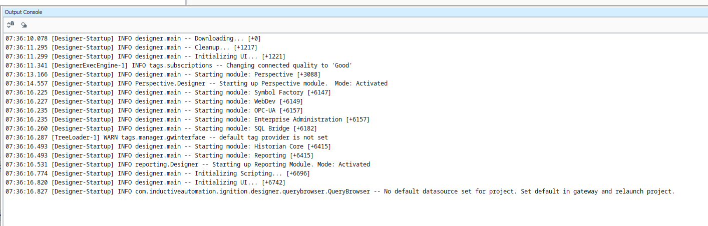

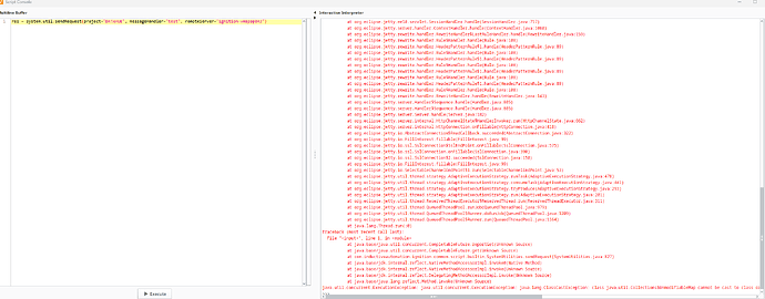

**Author:** ![Jean-Maurice\_Dubois](https://sea1.discourse-cdn.com/inductiveautomation/user_avatar/forum.inductiveautomation.com/jean-maurice_dubois/32/80996_2.png) [@Jean-Maurice\_Dubois](https://forum.inductiveautomation.com/u/Jean-Maurice_Dubois)\
**Post date:** [September 23, 2025, 3:02pm UTC](https://forum.inductiveautomation.com/t/sendrequest-not-possible-in-script-console/110891/3 "2025-09-23T15:02:31Z")
the payload does not seems to be the problem: here another test:
no payload
 ![image](https://us1.discourse-cdn.com/inductiveautomation/original/3X/a/7/a70f9e6fde4b52dd5826c2614ade57a48aac31ca.png)
messageHandler only return a string :
 ![image](https://us1.discourse-cdn.com/inductiveautomation/original/3X/e/6/e637541321536829ca4ecda155d106ff97dccbe0.png)
**Post date:** [September 23, 2025, 4:00pm UTC](https://forum.inductiveautomation.com/t/sendrequest-not-possible-in-script-console/110891/5 "2025-09-23T16:00:02Z")
```python
Java Traceback:
Traceback (most recent call last):

Caused by: java.util.concurrent.ExecutionException: java.lang.ClassCastException: class java.util.Collections$UnmodifiableMap cannot be cast to class org.python.core.PyDictionary (java.util.Collections$UnmodifiableMap is in module java.base of loader 'bootstrap'; org.python.core.PyDictionary is in unnamed module of loader 'app')
	at java.base/java.util.concurrent.CompletableFuture.reportGet(Unknown Source)
	at java.base/java.util.concurrent.CompletableFuture.get(Unknown Source)
	at com.inductiveautomation.ignition.common.script.builtin.SystemUtilities.sendRequest(SystemUtilities.java:827)
	at java.base/jdk.internal.reflect.NativeMethodAccessorImpl.invoke0(Native Method)
	at java.base/jdk.internal.reflect.NativeMethodAccessorImpl.invoke(Unknown Source)
	at java.base/jdk.internal.reflect.DelegatingMethodAccessorImpl.invoke(Unknown Source)
	at java.base/java.lang.reflect.Method.invoke(Unknown Source)
	at org.python.core.PyReflectedFunction. __call__ (PyReflectedFunction.java:190)
	... 18 more
Caused by: java.lang.ClassCastException: class java.util.Collections$UnmodifiableMap cannot be cast to class org.python.core.PyDictionary (java.util.Collections$UnmodifiableMap is in module java.base of loader 'bootstrap'; org.python.core.PyDictionary is in unnamed module of loader 'app')
	at com.inductiveautomation.ignition.gateway.script.rpc.ScriptMessagingRpcImpl.extractPayload(ScriptMessagingRpcImpl.java:93)

If you freshly launch the designer, does this problem still occur?
If so, is there an error at the beginning of your designer's logging output with a message `Failed to retrieve script message encoding, defaulting to JSON`? If so, can you post the full related stacktrace here?
**Post date:** [September 24, 2025, 11:38am UTC](https://forum.inductiveautomation.com/t/sendrequest-not-possible-in-script-console/110891/10 "2025-09-24T11:38:47Z")
If you mean the Output Console, no there isn’t.
 ![image](https://us1.discourse-cdn.com/inductiveautomation/original/3X/0/3/03b10cbb83749b1c9225de45a5a58244bc99d0e7.png)
still getting this error in Script Console

I don’t see anything in the gateway logs either.

at org.eclipse.jetty.server.Handler$Sequence.handle(Handler.java:805)
at org.eclipse.jetty.server.Server.handle(Server.java:182)
at org.eclipse.jetty.server.internal.HttpChannelState$HandlerInvoker.run(HttpChannelState.java:662)
at org.eclipse.jetty.server.internal.HttpConnection.onFillable(HttpConnection.java:418)
at org.eclipse.jetty.io.AbstractConnection$ReadCallback.succeeded(AbstractConnection.java:322)
at org.eclipse.jetty.io.FillInterest.fillable(FillInterest.java:99)
at org.eclipse.jetty.io.ssl.SslConnection$SslEndPoint.onFillable(SslConnection.java:575)
at org.eclipse.jetty.io.ssl.SslConnection.onFillable(SslConnection.java:390)
at org.eclipse.jetty.io.ssl.SslConnection$2.succeeded(SslConnection.java:150)
at org.eclipse.jetty.io.SelectableChannelEndPoint$1.run(SelectableChannelEndPoint.java:53)
at org.eclipse.jetty.util.thread.strategy.AdaptiveExecutionStrategy.runTask(AdaptiveExecutionStrategy.java:478)
at org.eclipse.jetty.util.thread.strategy.AdaptiveExecutionStrategy.consumeTask(AdaptiveExecutionStrategy.java:441)
at org.eclipse.jetty.util.thread.strategy.AdaptiveExecutionStrategy.tryProduce(AdaptiveExecutionStrategy.java:293)
at org.eclipse.jetty.util.thread.strategy.AdaptiveExecutionStrategy.run(AdaptiveExecutionStrategy.java:201)
at org.eclipse.jetty.util.thread.ReservedThreadExecutor$ReservedThread.run(ReservedThreadExecutor.java:311)
at org.eclipse.jetty.util.thread.QueuedThreadPool.runJob(QueuedThreadPool.java:979)
at org.eclipse.jetty.util.thread.QueuedThreadPool$Runner.doRunJob(QueuedThreadPool.java:1209)
at org.eclipse.jetty.util.thread.QueuedThreadPool$Runner.run(QueuedThreadPool.java:1164)
at java.base/java.lang.Thread.run(Unknown Source)
in gateway logs
