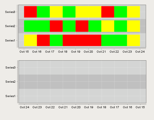

I’m putting together a template that only shows the chart without any labels. Depending on what machine is passed in, the chart should display the status from the last 24 hours, kind of like a progress bar. But it reads from right-to-left. In our application, it would be more intuitive filling in left-to-right.
I can’t change it like I can a property on the progress bar.
I can’t rotate it.
We started out by binding it to tag history and can’t figure out how to manipulate that data.
I’m attempting to bind the dataset to a SQL Query to maybe sort differently, but haven’t been able to make that work.
Has anyone been able to reverse the display for the series chart?
Thanks!

**Post date:** [October 18, 2017, 5:00pm UTC](https://forum.inductiveautomation.com/t/series-chart-left-to-right/15705/4 "2017-10-18T17:00:31Z")
Apologies - I completely glossed over that you were using the Status Chart. That said, basically the same code functions - but it doesn’t appear to actually do what you want (in some quick testing):
You can add this to the `propertyChange` event handler:
```auto
if event.propertyName == 'componentRunning':
	event.source.getChart().getPlot().getDomainAxis().setInverted(True)
And it will flip the order of the series displayed (eg, series 3, 2, 1 instead of series 1, 2, 3). You can also change it to `getRangeAxis().setInverted(True)`, and it _will_ flip the displayed dates - but it appears the rendering we’re doing over the top of things doesn’t know how to handle that, and so it just disappears completely:
 ![](https://us1.discourse-cdn.com/inductiveautomation/original/2X/2/24aacebcfd9bdd808f1430e636e5a2b71d57f2c5.png)
