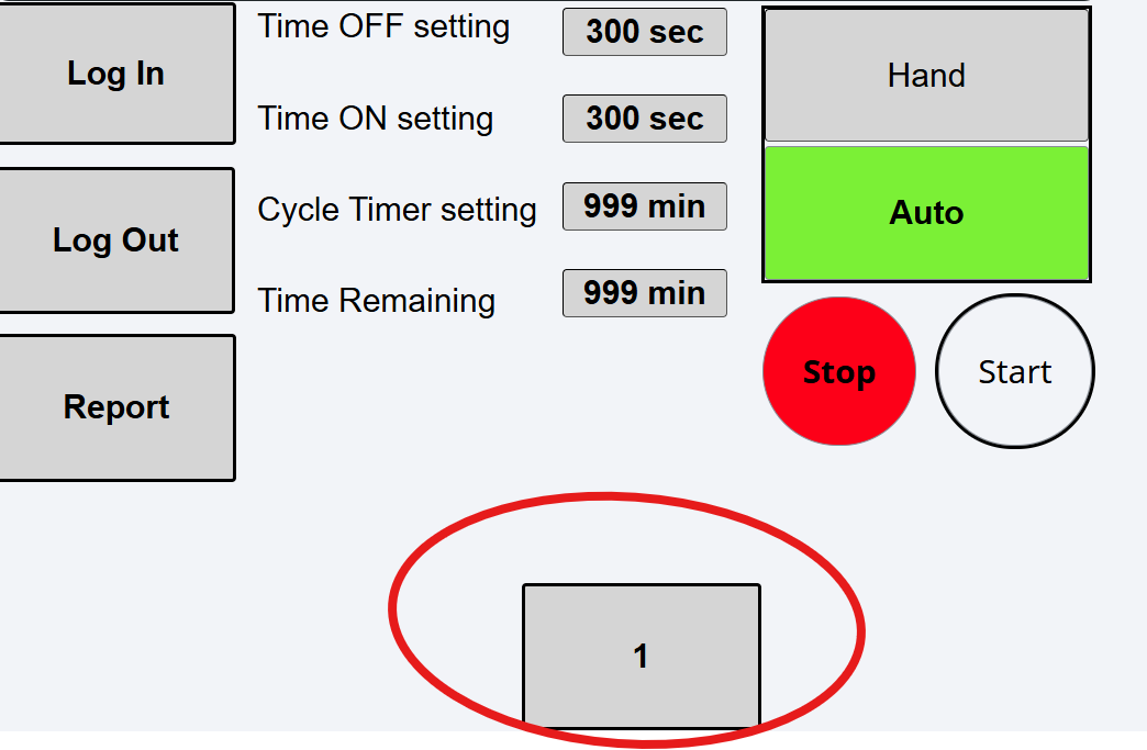

I need to turn on a bit when a user is logged into the system session.props.auth.user.userName. I can get it work in my dashboard but not sure how to get a tag to 1/0 to turn on a bit in my plc to prevent machine from running without an operator being logged into the system.

**Author:** ![Thomas\_McHale](https://avatars.discourse-cdn.com/v4/letter/t/7feea3/32.png) [@Thomas\_McHale](https://forum.inductiveautomation.com/u/Thomas_McHale)\
**Post date:** [August 13, 2025, 12:23pm UTC](https://forum.inductiveautomation.com/t/session-props-username/109686/7 "2025-08-13T12:23:56Z")
![image](https://us1.discourse-cdn.com/inductiveautomation/original/3X/4/f/4f9bbc2c1c6070bf969ba90c544bd51771d85b2c.png)
 ![image](https://us1.discourse-cdn.com/inductiveautomation/original/3X/5/2/52053fd905aa3eb5789a734c71ef7ba5ff115e16.png)
now need my tag to display this 1 ir 0
**Post date:** [August 13, 2025, 12:26pm UTC](https://forum.inductiveautomation.com/t/session-props-username/109686/8 "2025-08-13T12:26:09Z")
You should not try to do this in the session. Instead, use a gateway timer event that calls [system.perspective.getSessionInfo()](https://www.docs.inductiveautomation.com/docs/8.1/appendix/scripting-functions/system-perspective/system-perspective-getSessionInfo) every ten seconds, or minute, or whatever you need. The script would loop through the results to check for the desired status, perhaps ignoring designer sessions, and writing `True` to the target tag if a suitable session is found. (And returning early.) Write `False` if no qualifying session is found.

yes have users and levels set and controlling access to params and etc. just need a bit to tell me they are logged into the system.

**Post date:** [August 13, 2025, 12:51pm UTC](https://forum.inductiveautomation.com/t/session-props-username/109686/12 "2025-08-13T12:51:20Z")
> [@Thomas\_McHale](#):
Yes, use a gateway timer event that writes the bit based on the sessions present. 🤷‍♂️
