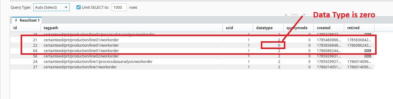

Hi,
We would like to display two string tags in the Perspective Power Chart alongside the numeric process tags, as this would provide users with additional context and insights. I attempted to add the string tags; however, the chart displays the tag source as "Not Available" even though the tags exist and are accessible. I have attached a screenshot for reference.
 ![image](https://us1.discourse-cdn.com/inductiveautomation/original/3X/b/1/b1435b566747cf4f2b6df6a6bd87ba109554d365.jpeg)
Thanks
Jayachandran M

Actually, I stand corrected - it _does_ appear to work in 8.1.51
 ![image](https://us1.discourse-cdn.com/inductiveautomation/original/3X/a/9/a919dcb7517d0db8c22bdc2dc085e67a62062cfe.png)
What version are you in?

My version is 8.3.2.

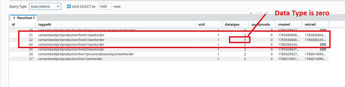

This is working fine for me now. Earlier, it was showing an error, so I tried executing `system.tag.queryTagHistory()`. I noticed that no data was being returned for the tag, even though the Tag Browser showed the history icon and tag history was enabled in the tag configuration.
To troubleshoot, I simply disabled tag history and then re-enabled it. After doing this, the query started returning data and the issue was resolved.
I also verified in the Query Browser that the data type value for the tag was `0`.
