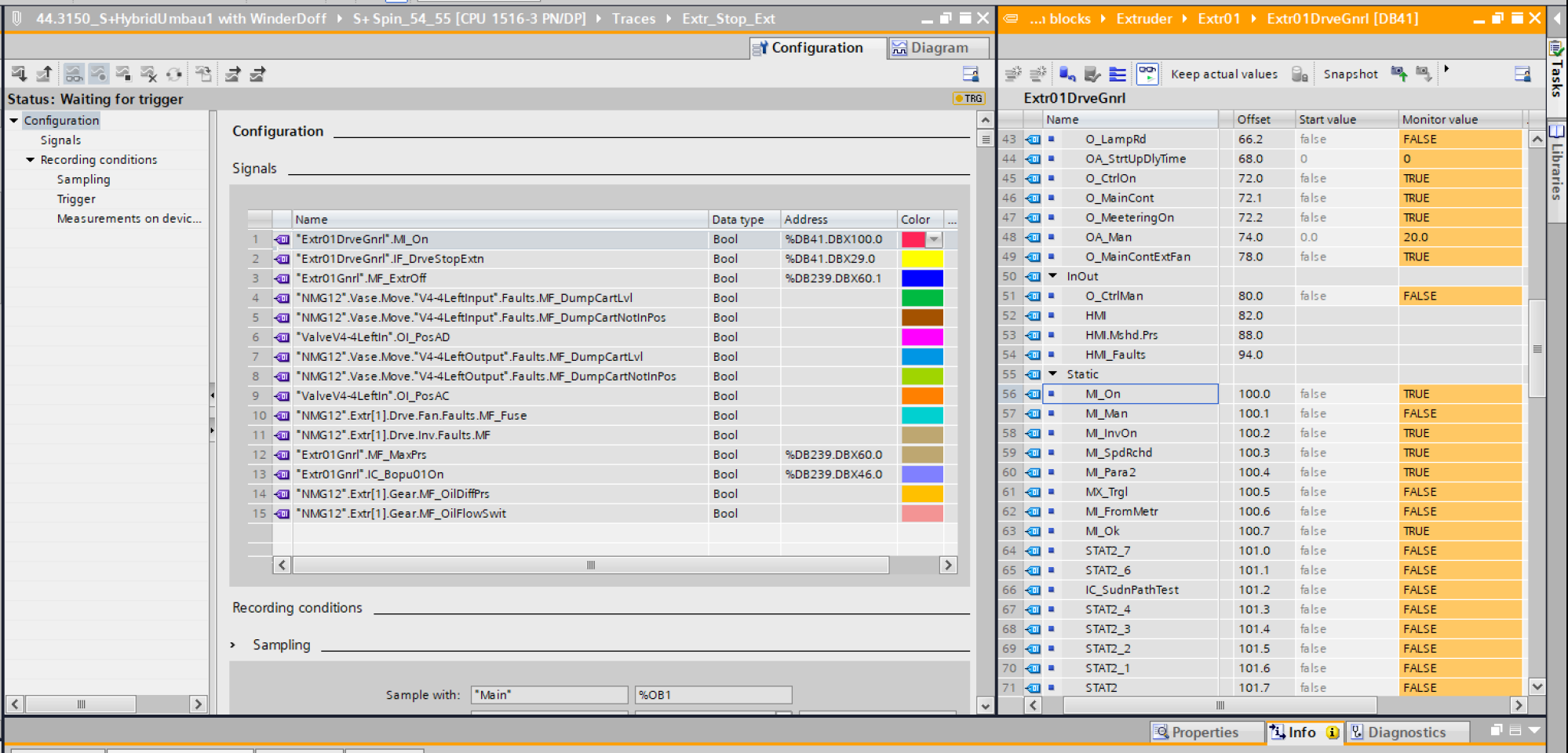

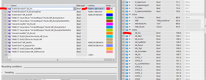

I need some help to address the static of this location:
 ![image](https://us1.discourse-cdn.com/inductiveautomation/original/3X/f/f/ff94ce71606401d123bc0c82ea3ccd944f74a58e.png)

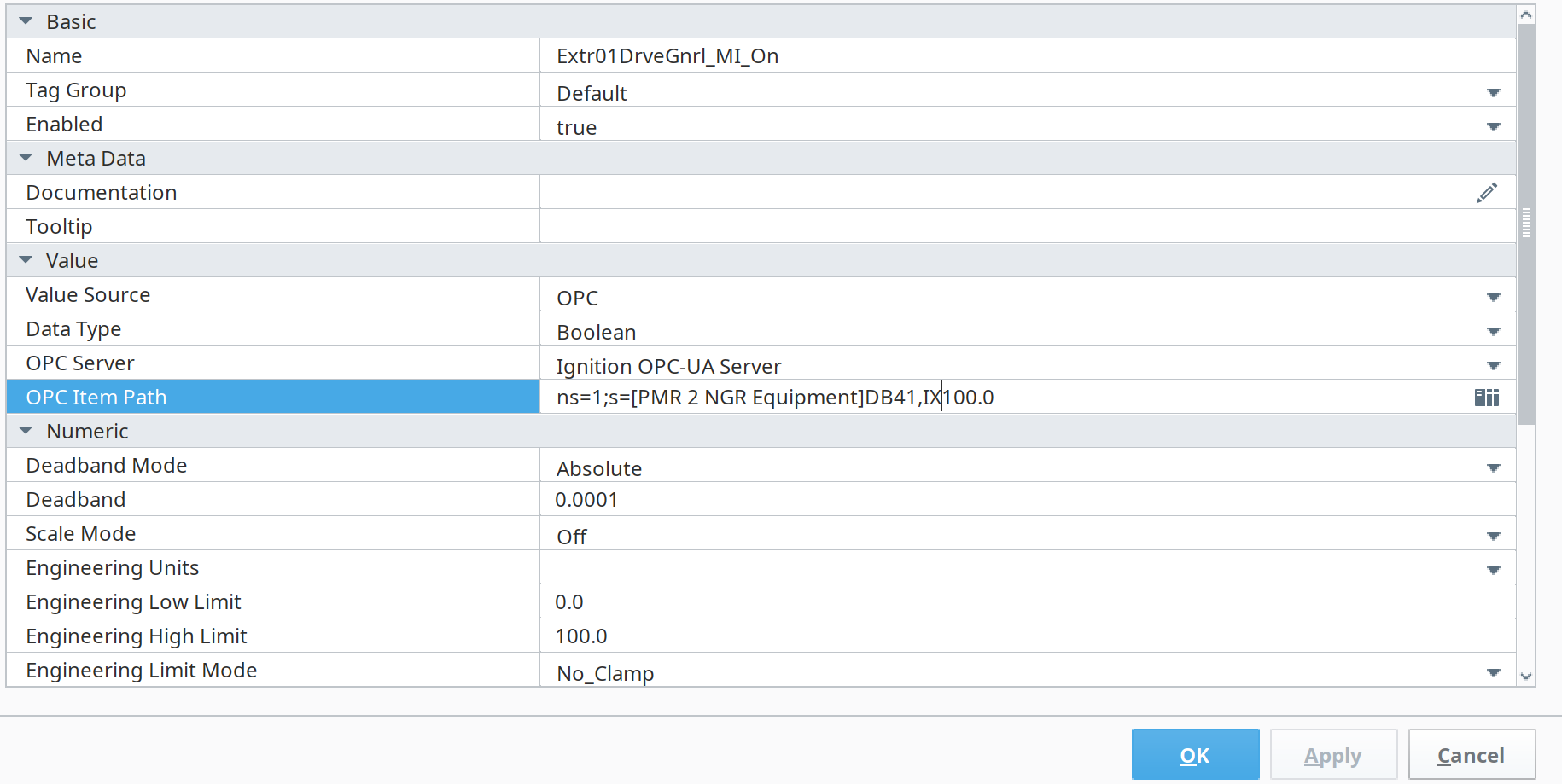

I have the tag setup like this what am I missing?
 ![image](https://us1.discourse-cdn.com/inductiveautomation/original/3X/3/4/3476fe86e520565e4c9f7e35939f026cd61930b1.png)
it returns an error configuration
**Post date:** [January 31, 2025, 3:54pm UTC](https://forum.inductiveautomation.com/t/siemens-addressing-help/68423/4 "2025-01-31T15:54:06Z")

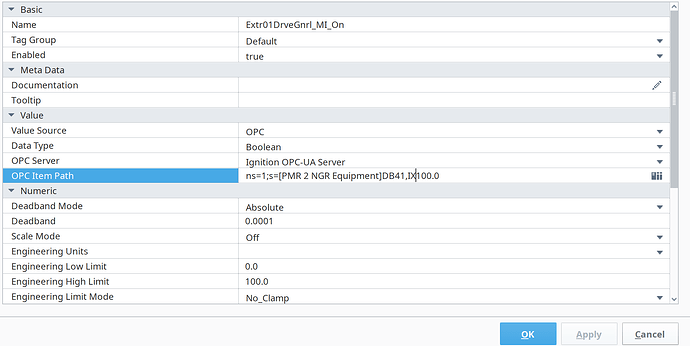

Address should be `DB41,X100.0` (not `IX`).
**Author:** ![mjohnson0238](https://avatars.discourse-cdn.com/v4/letter/m/4bbf92/32.png) [@mjohnson0238](https://forum.inductiveautomation.com/u/mjohnson0238)\
**Post date:** [January 31, 2025, 3:55pm UTC](https://forum.inductiveautomation.com/t/siemens-addressing-help/68423/5 "2025-01-31T15:55:58Z")
Ah, ok. Thank you.
I have it changed
I have this error now:
[null, Bad("Bad\_ConfigurationError: There is a problem with the configuration that affects the usefulness of the value."), Fri Jan 31 09:54:23 CST 2025 (1738338863794)]
Here is the online view of the PLC, so I can see the tag does read
 ![image](https://us1.discourse-cdn.com/inductiveautomation/original/3X/5/7/57e699537853b41b8a2234ca3e23da5739670050.png)
**Post date:** [January 31, 2025, 4:36pm UTC](https://forum.inductiveautomation.com/t/siemens-addressing-help/68423/6 "2025-01-31T16:36:10Z")
ConfigError when the syntax is correct is almost always because you don't have PUT/GET and/or full access enabled. Changing these requires both software and hardware compilation/download.
It can also happen when you try to read beyond the end of a data block, but it looks like you're online and that address exists.
> **[Siemens | Ignition User Manual](https://docs.inductiveautomation.com/docs/8.1/ignition-modules/opc-ua/opc-ua-drivers/siemens#considerations-for-1200-and-1500-devices)**
> The Siemens drivers in Ignition support basic connections to S7 devices. Ignition connects to these PLCs via TCP/IP using the S7 protocol. Similar to Modbus and some Allen Bradley connections, the Siemens S7 devices do not support tag browsing. You...
**Post date:** [January 31, 2025, 6:26pm UTC](https://forum.inductiveautomation.com/t/siemens-addressing-help/68423/7 "2025-01-31T18:26:01Z")
Yeah looks like the PUT/GET is not on. thanks for the info.
