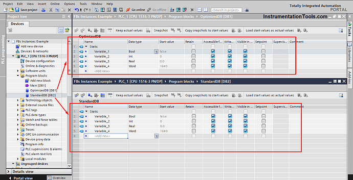

Hello
I’m trying to set a tag with an optimized data block from new Siemens PLC.
How can i access directly to an address by name?
 ![image](https://us1.discourse-cdn.com/inductiveautomation/original/3X/8/a/8acba2e4e4e9e68f75b01c176db49c033288c628.png)
**Author:** ![David\_Stone](https://sea1.discourse-cdn.com/inductiveautomation/user_avatar/forum.inductiveautomation.com/david_stone/32/79749_2.png) [@David\_Stone](https://forum.inductiveautomation.com/u/David_Stone)\
**Post date:** [November 5, 2025, 10:25am UTC](https://forum.inductiveautomation.com/t/siemens-plc-optimized-db-access/111953/2 "2025-11-05T10:25:10Z")
Use Ignition 8.3, buy the Siemens Enhanced Driver.
Follow the University Course:
> **[Siemens Enhanced Symbolic Driver Video at Inductive University](https://inductiveuniversity.com/videos/siemens-enhanced-symbolic-driver/8.3)**
> In this lesson, we walk through setting up a new device connection with the Siemens Enhanced Symbolic Driver and then use the browsing feature in the designer to explore the blocks and tags associated with a Siemens S7 1200 device. The approach...
