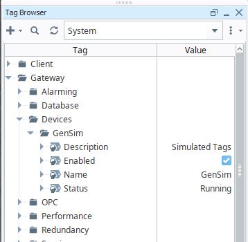

Hello, I’m kinda of new with Ignition. I have upgraded to trial v8.1.3. I followed instructions including videos to create new Simulator tags via Programmable Device Simulator. I can see first folder created but no tags listed. Is there a permission or security that I need to enable? Or am I missing something here? Much appreciated!
![GenSim](https://us1.discourse-cdn.com/inductiveautomation/original/3X/2/5/25786212aba1bae29997f6fef5ad2594e82ac7c9.jpeg)
 ![GenSim tags working good](https://us1.discourse-cdn.com/inductiveautomation/original/3X/b/9/b98deb74820a60d88a68fe926e6ac85372834569.jpeg)

Your first screenshot is from the tag browser and from the looks of it you just haven’t gone and added those additional tags to Ignition yet.

Are you saying that I need to add some tags and put them in GenSim folder in the Tag Browser screen? If that is the case, then I couldn’t add any new tags. In the Tag Browser screen, when I click on plus symbol and Browser Devices is unselectable. And if I right click on my mouse, New Tag is also unselectable. Makes me think there is some kind of security/permission somewhere to be enabled. Thanks.

Yes, that’s what I’m talking about doing.
I think the confusion here is because you have the “System” tag provider selected in that drop down. Try changing it back to “default”.

Yes! Now I have the tags available! The Tag Browser is definitely a bit different this time. Thanks for the help!
