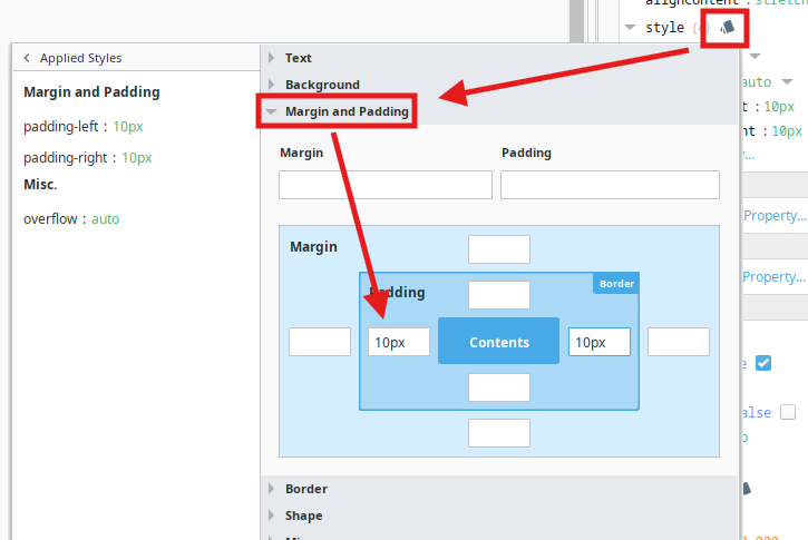

I have a horizontal slider in a flex container, ranging 0-750.
![image](https://us1.discourse-cdn.com/inductiveautomation/original/3X/0/c/0c25a0ce2b084c01f8d86b56052d1af676b4c37a.png)
As you can see, the zero and 750 are cut in half. What property can I change to pad this in a bit? I’ve tried tweaking a few to no effect.
8.1.25
**Author:** ![dillon](https://sea1.discourse-cdn.com/inductiveautomation/user_avatar/forum.inductiveautomation.com/dillon/32/81537_2.png) [@dillon](https://forum.inductiveautomation.com/u/dillon)\
**Post date:** [November 6, 2025, 7:47pm UTC](https://forum.inductiveautomation.com/t/slider-in-flex-container/112012/2 "2025-11-06T19:47:17Z")
Padding to the parent flex container or adding margin to the component itself.
 ![image](https://us1.discourse-cdn.com/inductiveautomation/original/3X/7/2/72a43952e458581d5b7820585df3da60f72140fe.png)
**Author:** ![Matrix\_Engineering](https://sea1.discourse-cdn.com/inductiveautomation/user_avatar/forum.inductiveautomation.com/matrix_engineering/32/19781_2.png) [@Matrix\_Engineering](https://forum.inductiveautomation.com/u/Matrix_Engineering)\
**Post date:** [November 6, 2025, 7:49pm UTC](https://forum.inductiveautomation.com/t/slider-in-flex-container/112012/3 "2025-11-06T19:49:59Z")
Aha, hiding in there. Thanks!
