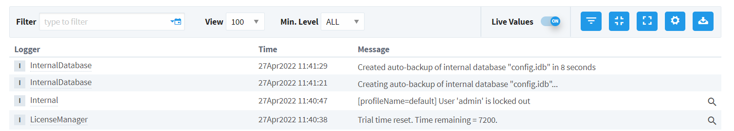

Good morning,
I was logged into an admin account on Ignition 8.1.12 and an operator rebooted the gateway PC. I then tried logging into the admin account several times which locked out the account (it was rebooting).
Luckily there was a backup admin account we could access but now we can’t login to the primary admin account. We can create new admin accounts and login but if we create an admin account with the original account name (new password) we can’t login to that account.
We have tried a reboot and got nothing.
Is there anything else we can do to recover the original admin account?

The lockout of an account is time-based (default of 15 minutes, see properties here: [Classic Authentication Strategy - Ignition User Manual 8.1 - Ignition Documentation](https://docs.inductiveautomation.com/display/DOC81/Classic+Authentication+Strategy#ClassicAuthenticationStrategy-MainProperties)). You can also re-save a given user source to reset any active lockouts.

Are you getting anything useful in the gateway logs when attempting to login with this account?

**Author:** ![bmeyers](https://sea1.discourse-cdn.com/inductiveautomation/user_avatar/forum.inductiveautomation.com/bmeyers/32/37453_2.png) [@bmeyers](https://forum.inductiveautomation.com/u/bmeyers)\
**Post date:** [April 27, 2022, 4:42pm UTC](https://forum.inductiveautomation.com/t/solved-lost-access-to-admin-account-due-to-reboot/58937/5 "2022-04-27T16:42:41Z")
So I deleted the user admin, re-added them, tried to login, and it failed. This is the only log message from that event.

**Author:** ![kcollins](https://sea1.discourse-cdn.com/inductiveautomation/user_avatar/forum.inductiveautomation.com/kcollins/32/19646_2.png) [@kcollins](https://forum.inductiveautomation.com/u/kcollins)\
**Post date:** [April 27, 2022, 4:48pm UTC](https://forum.inductiveautomation.com/t/solved-lost-access-to-admin-account-due-to-reboot/58937/8 "2022-04-27T16:48:20Z")
It looks like based on your screenshot, that profile should be `default`. You might try to go to _Config → Security → User Sources_ and _Edit_ that `default` user source–simply scroll to the bottom and click _Save Changes_ to release any active lockouts. It might be interesting to then monitor the logs (prior to attempting a further login) to see if another lockout occurs. That might be an indication that there is a lingering designer session somewhere attempting to re-authenticate with the wrong credentials and causing a lockout.

**Post date:** [April 27, 2022, 4:53pm UTC](https://forum.inductiveautomation.com/t/solved-lost-access-to-admin-account-due-to-reboot/58937/9 "2022-04-27T16:53:58Z")
Another guy here found this thread.
> [@\[FEATURE-1570\] User lockout feature](https://forum.inductiveautomation.com/t/feature-1570-user-lockout-feature/30413/2):
> Hi @justin.brzozoski - The only way to immediately clear the lockout is to disable lockout on a user source profile and save. You can then immediately re-enable the lockout and save (if you wish to keep it enabled). This clears all current lockouts for all users for the user source profile.
And it appears we have access again. It is very weird that deleting the user and re-adding them didn't clear the lockout.
**Post date:** [April 28, 2022, 9:48pm UTC](https://forum.inductiveautomation.com/t/solved-lost-access-to-admin-account-due-to-reboot/58937/11 "2022-04-28T21:48:59Z")
Circled back on this, it does look like a simple re-save of the user profile is enough to reset the lockouts (no need to disable and re-enable). This aligns with the current guidance in the docs.
