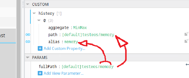

The custom:
 ![{3C99BA70-053F-489D-8FB7-A0C2C8DF068E}](https://us1.discourse-cdn.com/inductiveautomation/original/3X/f/6/f648598dddfdbdd6dd04f8e1eb47649422bd4aca.png)
How I set up sortOrder:
 ![{A0323743-25D4-4D8F-AAC7-DE9DA0D214BF}](https://us1.discourse-cdn.com/inductiveautomation/original/3X/c/1/c109735d88c2a4584385305c090b1f07356d0061.png)
Even setting the column to sort enable, descending and configuring sortOrder the table doesn't get sorted. Not sure what I'm doing wrong.
Any help is appreciated.
Thx!

Are **all** of your columns defined with a field assigned to them?
**Author:** ![danielps1818](https://avatars.discourse-cdn.com/v4/letter/d/ecae2f/32.png) [@danielps1818](https://forum.inductiveautomation.com/u/danielps1818)\
**Post date:** [December 16, 2025, 11:03am UTC](https://forum.inductiveautomation.com/t/sortorder-property-on-dates-perspective-table/112810/5 "2025-12-16T11:03:29Z")
Nope, only the column that I want.
Should I try to configure all of them? It makes little sense
**Post date:** [December 16, 2025, 1:11pm UTC](https://forum.inductiveautomation.com/t/sortorder-property-on-dates-perspective-table/112810/6 "2025-12-16T13:11:22Z")
If `props.columns` is **empty** or invalid, the table falls back to auto-interpreting `props.data` as best it cal.
If `props.columns` is present and valid, the columns it defines are the **only** columns that will be displayed in the table.
Define them all. Make sure each definition identifies the proper content in `props.data`.
