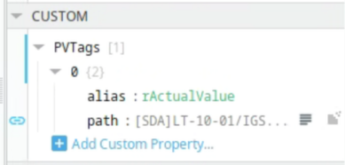

Hi,
I would like to use a sparkline display along with my transmitter value in Perspective. My goal is to provide a tag path to the view that contains the transmitter and sparkline to make them interactive. The transmitter parameter passing works fine, but I cannot get the sparkline to work properly.
According to this video, it should be possible to create a custom array of objects, with each object containing values for path, alias, and aggregate and use it in a Tag History Binding. The video is for a table but I think it should work for a sparkline as well since they both use Tag History Binding
[https://inductiveuniversity.com/videos/tag-history-binding—expression/8.0](https://inductiveuniversity.com/videos/tag-history-binding---expression/8.0)
I followed the format in the manual.;
"Using Dynamic Tag Paths
Tag History bindings have the option to list out Tag paths, or to use an expression to build a Tag path. It is common to create a dynamic path or set of paths as a component property, that you then reference in other places. You can use as many Tag paths as you want, but they must all follow this format:
key [array]
    [0] {object}
        aggregate value
        alias value
        path value
    [1]{object}
        aggregate value
        alias value
        path value
Here is my CUSTOM property for the sparkline:
 ![Capture](https://us1.discourse-cdn.com/inductiveautomation/original/3X/5/3/53ba964aa247df63ef0636625c8ca442e5a7f64b.jpeg)
When I bind the Tag History directly to a tag, it works fine, but when I try to use an expression, I get an error message:
 ![Capture2](https://us1.discourse-cdn.com/inductiveautomation/original/3X/a/3/a3240b5f8ce0c84e2ab5613526b057b098fa88ef.jpeg)
What am I doing wrong here? The PV is the data source for both the transmitter and sparkline. I know the sparkline uses tag history whereas the transmitter uses direct or indirect tags, but making the sparkline dynamic should be as simple as making the transmitter dynamic.
I can make the tag binding dynamic by using a parameter. All this does is to alter the tag path by adding some text to it.
 ![num1](https://us1.discourse-cdn.com/inductiveautomation/original/3X/6/0/60cf9e80c1f5df23ad3e1ac313eea5184daf3149.jpeg)
Why can’t the same option be used in a Tag History Binding? I understand a dataset is required, but if the configuration can take a direct tag path and create the dataset behind the scene, why can’t it use a parameter to alter the tag path and do the same thing as a direct path?
 ![num2](https://us1.discourse-cdn.com/inductiveautomation/original/3X/4/9/497a7cbe825521c7a24217b096d5a561b95a9620.jpeg)
Thank you,
Ali

I don’t think it accepts _default_ as an aggregate. Try something explicit, like _average_.

@deon.korb was _almost_ right. `aggregate: default` doesn’t appear to be supported. `aggregate: Average` works ( **case sensitive** )
I omit the alias parameter, as I believe it’s useless with a sparkline, and I omit the aggregate parameter, assuming it defaults to “average” - and my original query mode was “AsStored”.
(someone please correct me if I’m wrong).
Still, tag history indirection would be nice.
