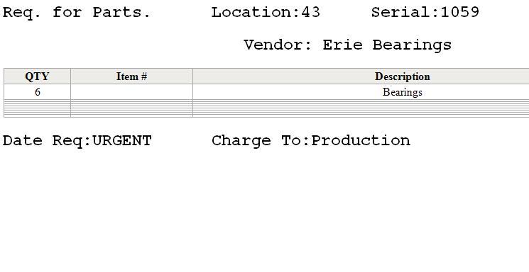

**Post date:** [April 3, 2009, 3:56pm UTC](https://forum.inductiveautomation.com/t/special-escape-characters/1064/3 "2009-04-03T15:56:45Z")
Ok attached is a screen shot of the HTML translated screen that is sent to purchasings email address. A copy is also sent to mine so that I know what problems are occuring.
As you can see we use the TABLE component to enter in the data. I was there when the mechanic had placed the order and I watched to make sure he had done so correctly.
In the place of ITEM#, he entered: CYR 7/8
This is the bearing number. However it did not send this information but it did send everything else as you can see.
We went back in and tried the following: CYR 7\8
Again it did not send this cell.
However when we entered in: CYR 7-8
Then it sent it. SO I am wondering if both forward and back slashes are similar when working with your software? I did find on the one site the list of special escape characters mentioned earlier in this post but it only mentioned the one.
Hope this helps.

**Post date:** [April 3, 2009, 4:18pm UTC](https://forum.inductiveautomation.com/t/special-escape-characters/1064/4 "2009-04-03T16:18:16Z")
I’m not sure that this has anything to do with our software. It looks like this HTML is generated by a script that you’ve written, yes? Have you looked at the source of the html? Is the cell contents there, just not being shown? If not, you’ll need to troubleshoot your script.

**Author:** ![Carl.Gould](https://sea1.discourse-cdn.com/inductiveautomation/user_avatar/forum.inductiveautomation.com/carl.gould/32/7262_2.png) [@Carl.Gould](https://forum.inductiveautomation.com/u/Carl.Gould)\
**Post date:** [April 3, 2009, 5:11pm UTC](https://forum.inductiveautomation.com/t/special-escape-characters/1064/6 "2009-04-03T17:11:04Z")
Neither forward nor backslash are special characters in HTML. I just tested the table, and it passes forward and backslashes through to the HTML generated by getDataAsHTML() just fine.
You said you were writing the data down to the database and the slashes were not there either - how was this writing occuring?
That said, your HTML is malformed in the extreme. You cannot have multiple or start tags in an HTML document, and you’ve mixed up the order of your end tags, although that doesn’t really matter since they shouldn’t be there anyways…
You need to do the trouble shooting more methodically. Where exactly are the slashes getting “lost”. Examine the return value of table.getDataAsHTML() - is the data there? Also, how is this table’s data property bound, if at all? What scripts run on table cell edit event, if any?
