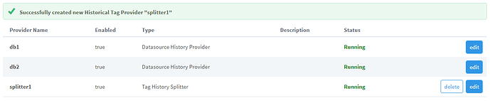

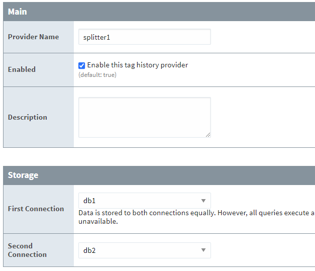

Sorry for the delay. I took a bit of time to try and replicate and was unable to do so on 8.1.35. Notable however, is that I did not replicate using the AWS Postgres instance as you did.
I did:
- Ignition 8.1.35
- MySQL 8.0: db1
- MySQL 8.0: db2
- Tag History Splitter: splitter1
I did not have any issues doing so. At this point, I would recommend getting in touch with our support team. They would be happy to help you troubleshoot, as I suspect there is something nuanced going on with the Datasource History providers that you are using.
Also, related to @pturmel 's recommendation, I assume you have modified the screenshots to hide the DB connection name as I was unable to add any spaces in a database connection name, so thankfully while his concern is valid, I don't think that is possible.
