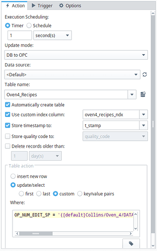

Good morning,
I pre-made a recipe list for a customer from the office but when I got on-site it looks like I was given some wrong information. At the office I used a custom made recipe editor to add fields into SQL with transaction groups. I added ~300 recipes with operation numbers, material number, names, etc. The problem I found is that lets say operation number “400” was in fact “0400” on their system.
So, instead of re-making all recipes with the new operation numbers I went in to SQL and edited all rows and added the “0” in front of every operation number. Now when I go to load the recipe from ignition, it can no longer find the recipe even though the operation number matches to what is in the SQL Database:
 ![image](https://us1.discourse-cdn.com/inductiveautomation/original/3X/1/9/19bf85701881155ad3251b8c2b93dde64df38950.png)
This only happens on any part that I had to edit with SQL. If I load a part that I didn’t edit (one that was already 4 characters long) it loads just fine.
Has anyone ran across this issue before? I am minor when it comes to SQL programming, but it almost seems like I have to re-initialize the database for Ignition to read it again. I can save the exact same part information into the database and it will find it after, but then I show two recipes with the same values. My search for my transaction group is the following:
OP\_NUM\_EDIT\_SP = ‘{[default]Collins/Oven\_4/DATABASE/OP\_NUM\_EDIT\_SP}’ AND MATERIAL\_NUM\_EDIT\_SP = ‘{[default]Collins/Oven\_4/DATABASE/MATERIAL\_NUM\_EDIT\_SP}’

What does the query you used to make the edit in SQL look like?
Is it possible that you used a transaction but didn’t confirm the changes? Perhaps the transaction is still open and your changes are in some kind of limbo?
If you do a select from the DB Management Suite does it find the data as you expect? If you try to Select the data based on the old Operation Number does that work?

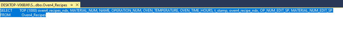

![image](https://us1.discourse-cdn.com/inductiveautomation/original/3X/e/b/eb5711c6404e59ff71c7f2a06d1912b628faee81.png)
This is the statement I used and then edited all rows in operation number column. I used the pre-caned EDIT TOP 200 Rows then just changed the 200 to 1000
I made the changes and closed the SQL studio.
It does find the data as expected. The old operation number does not come up.

Huh.
I would expect it to work.
What if you run a select statement from the Database Query Browser in ignition. Does that work as expected?
Clearly I’m guessing here, I would have expected this to work.
You may want to get a hold of support and have them take a look.

**Post date:** [April 28, 2022, 1:44pm UTC](https://forum.inductiveautomation.com/t/sql-edit-command-doesnt-allow-transaction-group-to-find-value/58980/6 "2022-04-28T13:44:57Z")
What are your column types?
Some things to check:
- In some environments, an extra leading zero on an integer causes it to be interpreted as octal instead of decimal.
- To reliably use leading zeros, the column types must be characters, not numbers. And all of the properties and parameters along your query chain must also be strings.

**Post date:** [April 28, 2022, 2:46pm UTC](https://forum.inductiveautomation.com/t/sql-edit-command-doesnt-allow-transaction-group-to-find-value/58980/8 "2022-04-28T14:46:53Z")
Might just be a typo but it looks like you are selecting the ndx field twice but one is recipes and the other is recipe?
oven4\_recipes\_ndx and oven4\_recipe\_ndx?
**Author:** ![james4](https://sea1.discourse-cdn.com/inductiveautomation/user_avatar/forum.inductiveautomation.com/james4/32/49597_2.png) [@james4](https://forum.inductiveautomation.com/u/james4)\
**Post date:** [April 28, 2022, 2:49pm UTC](https://forum.inductiveautomation.com/t/sql-edit-command-doesnt-allow-transaction-group-to-find-value/58980/9 "2022-04-28T14:49:04Z")

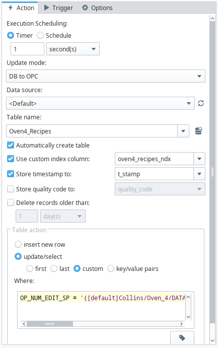

This is what I have set up in the transaction group manager:
 ![image](https://us1.discourse-cdn.com/inductiveautomation/original/3X/e/a/eac7e7ab08ffb6715f69263951ab0feb1ca66999.png)
But I am not searing based on the index just the combination of the operation number and material number.
**Author:** ![MMaynard](https://sea1.discourse-cdn.com/inductiveautomation/user_avatar/forum.inductiveautomation.com/mmaynard/32/3366_2.png) [@MMaynard](https://forum.inductiveautomation.com/u/MMaynard)\
**Post date:** [April 28, 2022, 3:02pm UTC](https://forum.inductiveautomation.com/t/sql-edit-command-doesnt-allow-transaction-group-to-find-value/58980/10 "2022-04-28T15:02:15Z")
I just created a DB to OPC group as a test and it is working fine with a similar setup.
One thing I am noticing is you have single quotes around the tag in the Where clause.
Try removing the single quotes, they aren’t needed.
**Post date:** [April 28, 2022, 3:29pm UTC](https://forum.inductiveautomation.com/t/sql-edit-command-doesnt-allow-transaction-group-to-find-value/58980/11 "2022-04-28T15:29:44Z")
> [@MMaynard](#):
He's using strings. They are needed.
**Post date:** [April 28, 2022, 3:43pm UTC](https://forum.inductiveautomation.com/t/sql-edit-command-doesnt-allow-transaction-group-to-find-value/58980/12 "2022-04-28T15:43:57Z")
Works fine for me without them. 🤷‍♂️
