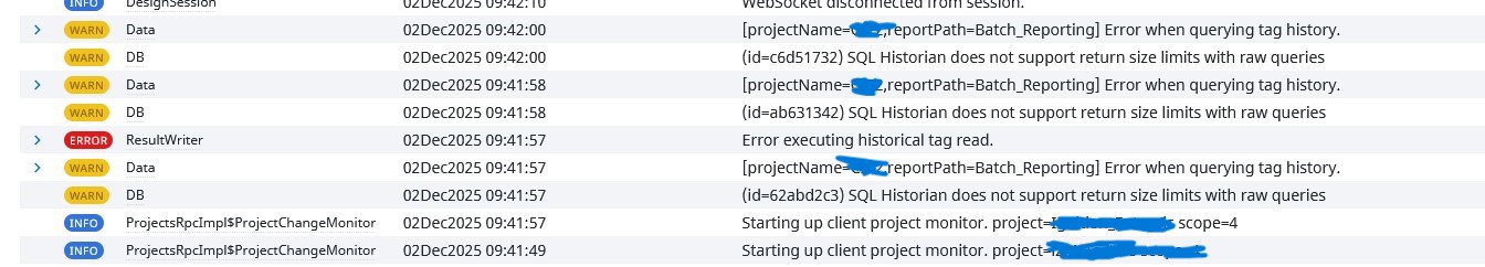

We upgraded to version 8.3 and now one of our reports is throwing an error, I see in the datasource that we are using a fixed sample size but no error in the designer. should I not be using Fixed sample size in history queries?
 ![error 2](https://us1.discourse-cdn.com/inductiveautomation/original/3X/b/4/b4ad09ec682289fef2418581defb3bb776c67309.jpeg)
 ![error](https://us1.discourse-cdn.com/inductiveautomation/original/3X/b/1/b18ad2c1b25c944f1345e3e40e2dd0afd37442e0.jpeg)

Did you solve this issue?
**Author:** ![drewdin](https://sea1.discourse-cdn.com/inductiveautomation/user_avatar/forum.inductiveautomation.com/drewdin/32/3363_2.png) [@drewdin](https://forum.inductiveautomation.com/u/drewdin)\
**Post date:** [June 10, 2026, 7:40pm UTC](https://forum.inductiveautomation.com/t/sql-historian-does-not-support-return-size-limits-with-raw-queries/112568/3 "2026-06-10T19:40:03Z")
From working with support, the fix was added in 8.3.4 and 8.3.5, you need to update to fix it.

i have fixed my post, i forgot to add the .3
