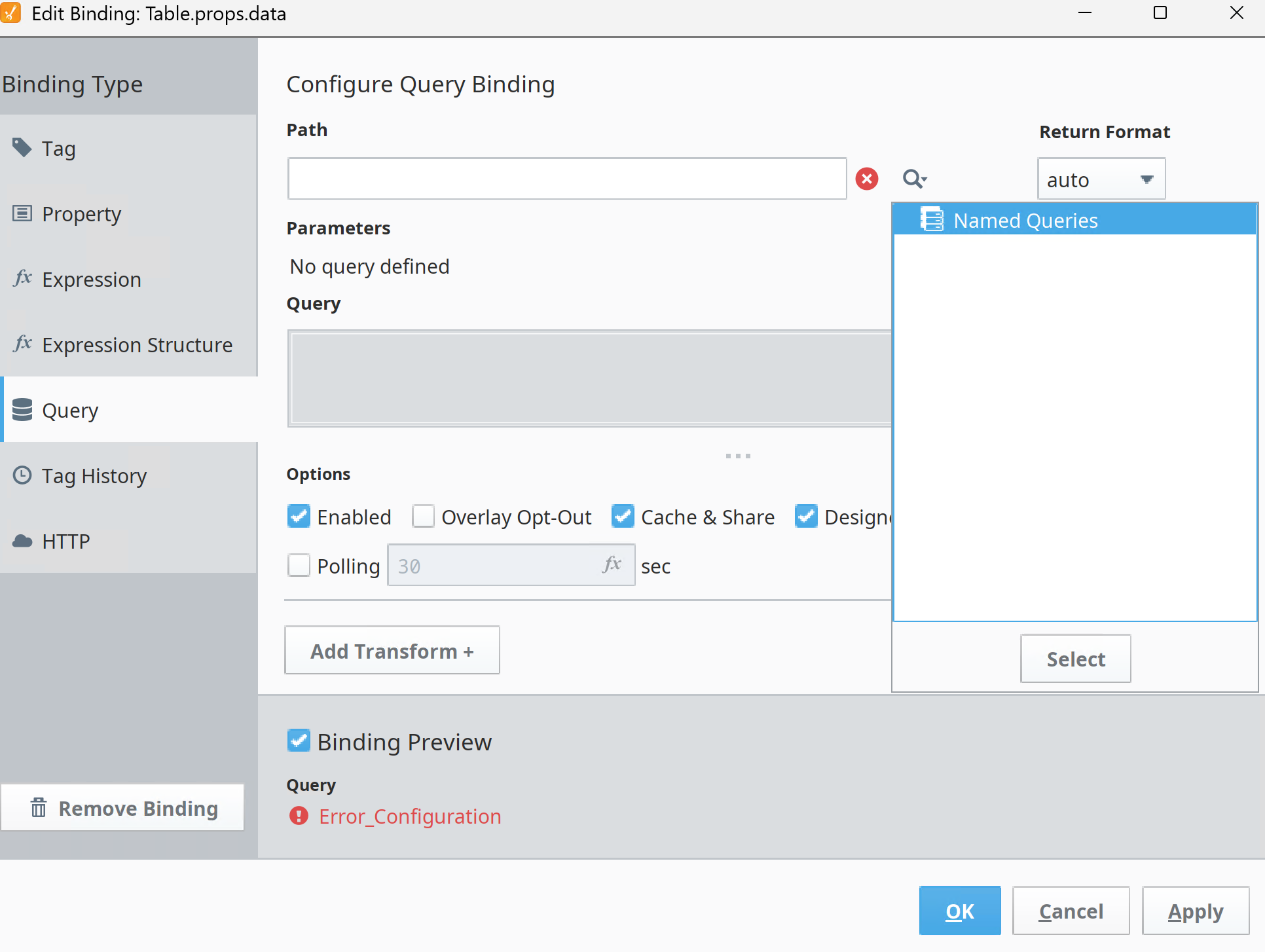

I saw there was the option but my database isn’t showing up. I’m sure I’m doing something wrong but I don’t know what
 ![image](https://us1.discourse-cdn.com/inductiveautomation/original/3X/4/c/4c2d6e326ad66ce2cbf3a6d74407688468382dd1.png)
**Post date:** [September 22, 2025, 4:56pm UTC](https://forum.inductiveautomation.com/t/sql-lookup-table/110841/4 "2025-09-22T16:56:20Z")
You need to create a named query first - do you have (saved) named queries in your current project?

**Post date:** [September 22, 2025, 5:00pm UTC](https://forum.inductiveautomation.com/t/sql-lookup-table/110841/6 "2025-09-22T17:00:06Z")
Okay, so you'll need to create a named query and add a parameter to it for your work order:
> **[Named Query Introduction Video at Inductive University](https://inductiveuniversity.com/videos/named-query-introduction/8.3)**
> Take a quick tour of the Named Query workspace.
> **[Named Query Parameters Video at Inductive University](https://inductiveuniversity.com/videos/named-query-parameters/8.3)**
> In this lesson, learn how to add both Value and QueryString parameters to a Named Query.
Then you'll be able to select that in the Perspective binding and link the query parameter to some property on your view.
