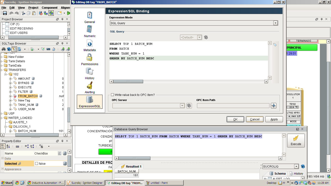

The attached picture describes my problem.
I am using the DB query browser, and receive a row with the value 161. I use the same query on a DB tag, and receive the value null, as displayed in the tag browser.

Interestingly enough, if I make a client tag with the same query, it returns the correct value.

Do you have a datasource specified for the SQLTags provider?
1. Log into the gateway
2. Go to SQLTags\>Realtime
3. Click “Edit” next to “default”
4. Set the default datasource.
If it’s already set, you’ll have to take a look at the logs to see what kind of error is occurring (or, if using 7.2, right click on the tag and click “tag diagnostics”)

Beautiful, thank you very much.
