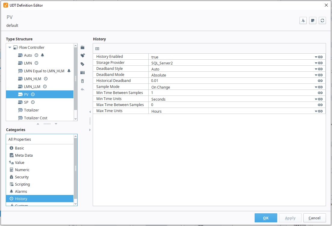

Okay so here are the settings they originally setup. I also included a second photo of their new revised settings they are using today after a call yesterday. Let me know if you have any comments.
Original Setup
 ![1 Origional Setting (HIGH VOLUME OF DATA)](https://us1.discourse-cdn.com/inductiveautomation/original/3X/5/5/55d9a97ebc1d13274e0b0a1daad6086b1696817c.jpeg)
Second Setup
 ![1 New Setting (Hoping for lower data)](https://us1.discourse-cdn.com/inductiveautomation/original/3X/5/1/51b7ed814f87ac3f6feb9da6a2701881491bedec.jpeg)
**Post date:** [March 30, 2023, 2:09pm UTC](https://forum.inductiveautomation.com/t/sqlt-data-x-x-table-is-consuming-gb-of-data-monthly/71785/5 "2023-03-30T14:09:26Z")
Periodic was the problem. It ignores the deadband. Just stores at the sample rate. Makes pretty graphs.
You may need to adjust that deadband. What are the normal range of values for these points. (No need to answer here--just tweak as needed.)
Consider setting a max time between samples of a a minute or two or five. It is helpful when charting if at least one or two real stored points appear on the smallest time range chart you typically use.

You hit the nail on the head pretty graphs. The issue is I really only need to see changes (but we do not know when the changes will occur) so that’s the trick to capture on active change and not miss anything. How or what setting does this tool have to do that? I come from a Rockwell Metrics background, their historian would do the same but we could choose one option and it was on demand change (not sure the actual element name) but it would watch a data point, if it changed it logged the data otherwise no data change no data writes. This kept the db small but still gave you functional graphs/data. They also allowed you to normalize the data by summarizing the data hourly. I am sure this tool can do the same they cannot be that drastically different.
![image001.jpg](https://us1.discourse-cdn.com/inductiveautomation/original/3X/c/1/c1123ee35ab6e2bf0f263f421ad16fee45206983.jpeg)
**Post date:** [March 30, 2023, 3:11pm UTC](https://forum.inductiveautomation.com/t/sqlt-data-x-x-table-is-consuming-gb-of-data-monthly/71785/7 "2023-03-30T15:11:34Z")
The adjustment made to "Sample Mode = On Change" will give you similar behavior to what you expect. But Ignition's charting doesn't like big gaps, even if it **should** be able to reconstruct, which is why I recommend setting "Max Time Between Samples" to a non-zero value (zero meaning infinity).
There's no built-in summarization functionality.
