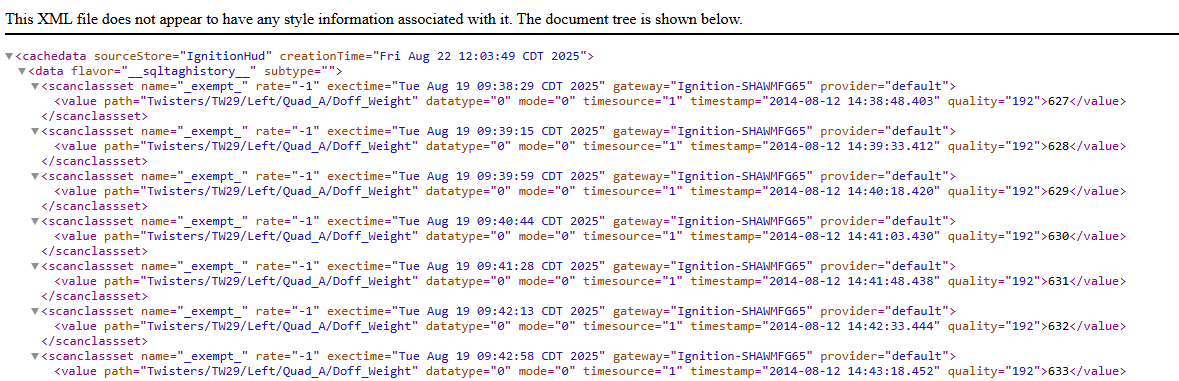

Problem:
Tag is being quarantined as shown below.
![image](https://us1.discourse-cdn.com/inductiveautomation/original/3X/1/b/1b01faceeebd4fe83a0d6e787f3c78ec0f066db9.png)
The timestamp of the tag shows time in 2014.
 ![image](https://us1.discourse-cdn.com/inductiveautomation/original/3X/2/0/206710a9555fbdfea9a9bd30a13fcfc5e67dd008.png)
Where should I start looking to resolve this issue? What other information can I provide to help. Thank you!
**Author:** ![ryan.white](https://sea1.discourse-cdn.com/inductiveautomation/user_avatar/forum.inductiveautomation.com/ryan.white/32/73193_2.png) [@ryan.white](https://forum.inductiveautomation.com/u/ryan.white)\
**Post date:** [August 22, 2025, 5:19pm UTC](https://forum.inductiveautomation.com/t/store-forward-quarantine-invalid-object-name/110120/2 "2025-08-22T17:19:04Z")
Check that your server system time and the system time on the device you are pulling the data from are the same, or at least within a couple of seconds of each other. In this case I would check the device first.
Ideally both the server and the device should be syncing off the same master clock.
