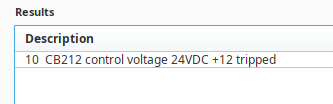

What I am trying to show
 ![image](https://us1.discourse-cdn.com/inductiveautomation/original/3X/a/a/aaf69ff999c9dfcb844fce8db4d6605bac5da6cc.png)
what I am showing right now from binding the label to my query:
 ![image](https://us1.discourse-cdn.com/inductiveautomation/original/3X/f/b/fbe92a4d7ebe04235f2365b1410ec5ab73589828.png)
the example result of my query:
 ![image](https://us1.discourse-cdn.com/inductiveautomation/original/3X/f/3/f3b7794bd9ce3e9b8f38890fbcfd1d6744ed0d9a.png)
I am not really sure how to transform this.
 ![image](https://us1.discourse-cdn.com/inductiveautomation/original/3X/e/9/e948c6194de93f6758a1a99210678668a5d74de8.png)
my query is receiving parameters to figure out which message to show
**Author:** ![dkhayes117](https://sea1.discourse-cdn.com/inductiveautomation/user_avatar/forum.inductiveautomation.com/dkhayes117/32/68344_2.png) [@dkhayes117](https://forum.inductiveautomation.com/u/dkhayes117)\
**Post date:** [February 8, 2022, 5:11pm UTC](https://forum.inductiveautomation.com/t/string-in-a-cell-of-a-query-to-a-label-transform/55870/2 "2022-02-08T17:11:09Z")
If you are only returning a single message from your query, you could change the query to be a scalar query so it returns a value and not a dataset.

In Python it’s
`if myVariable is None:`.
In expression language it’s
`if(isNull(myVariable), ..., ...)`
For your original problem:
`[{"Description": "10 CB212 control voltage 24VDC +12 tripped "}]`
you’ve got a dictionary `{ }` inside a list `[]`. You can retrieve the message string:
1. Switch the returned format to JSON (Document) format.
2. Add a script transform.
3. Modify the `return value` line to `return value[0]['Description']`.
The [0] is because the dictionary is the 0th element in the list.
You’ve already got a fix using the Scaler option but this may come in handy for other tasks.
