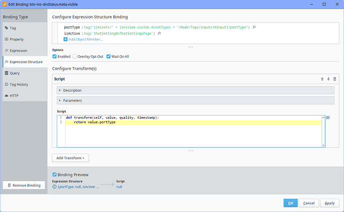

when i directly access the tag path, i get the value as expected (`curr_mA`). but when i try to make it dynamic, it just get `null`. can someone tell me what i'm doing wrong?
 ![Screenshot 2024-02-14 164046](https://us1.discourse-cdn.com/inductiveautomation/original/3X/6/6/66c3eb79b0ff256d517318f3a3a42bff22b2e869.png)

I would create custom properties with an indirect tag binding, rather than the `tag()` expression.
And then you can reference those properties in your expression structure if need be.
The problem with this:
```auto
tag("[]Assets/....")
Is that it is an invalid tag path. You have provided no TagProvider. If you want to use a default tag provider then you need to proved that TagProviders name, in this context (relative tag paths are invalid here).
So something like `tag("[default]Assest/....")`.
I can't say what the issue is with `isActive` because I don't know what the value of `thatSettingOnThatSettingsPage` is.
Seriously though - [Tag Bindings in Perspective - Ignition User Manual 8.1 - Ignition Documentation](https://docs.inductiveautomation.com/display/DOC81/Tag+Bindings+in+Perspective)
(Scroll down to Indirect Binding Mode)

> [@lrose](#):
Let me emphasize this. If you are using the `tag()` expression function in a user interface binding, you are screwing up.
You can find many rants here under my name on this topic.

"Thirding" this to drive it home!

> [@lrose](#):
placeholder. not germaine.
okay. i read (a lot) and i will create a custom property instead. thanks for the helpful pointer. i recall @pturmel saying something to this effect in another post, but i couldn't find it (fast enough). 😛
