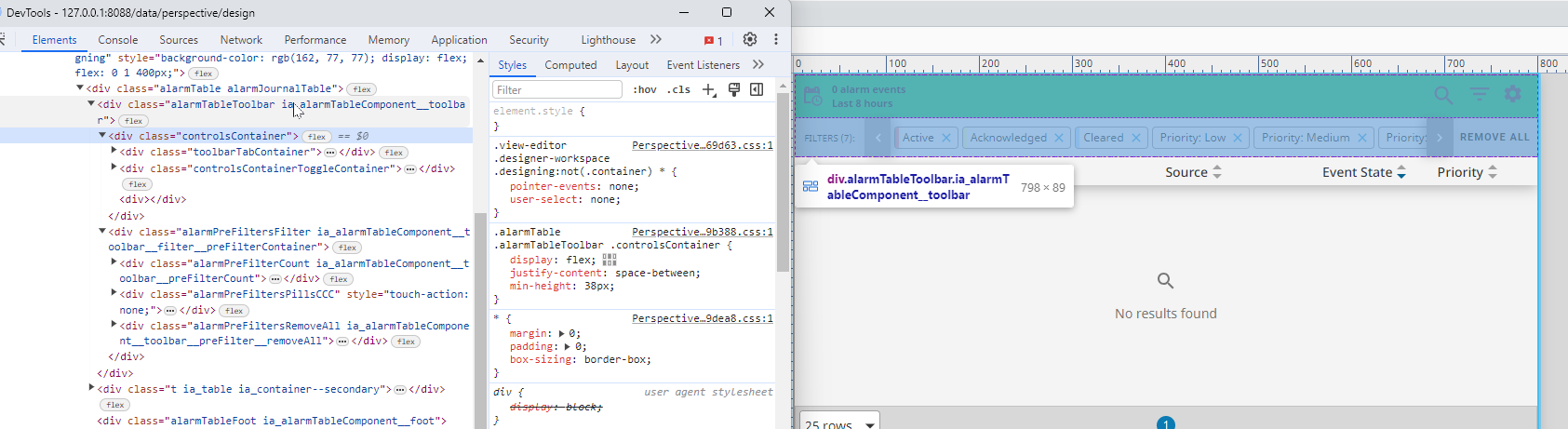

You'll need to do this with CSS via the adv. stylesheet / CSS theme files.
If you open the dev tools in the Designer / browser, you should be able to find the selectors you'll need:
 ![image](https://us1.discourse-cdn.com/inductiveautomation/original/3X/6/4/647cb51fca7a46dc871e6bd11df21b0063281692.png)
E.g.
 ![image](https://us1.discourse-cdn.com/inductiveautomation/original/3X/a/e/ae71f0727a42ed005bd2a91ba726026367ca8fdf.png)
