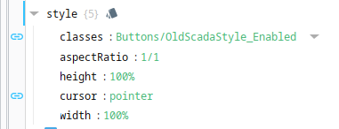

Why are Style properties that are in my styleclass not being applied to my component. Causing me to have to add in the properties manually on each component,
 ![image](https://us1.discourse-cdn.com/inductiveautomation/original/3X/7/c/7c5d82d858686b8597293349c86f54c1b4303daa.png)
here is a screenshot of the styleclass with those properties in it,
 ![image](https://us1.discourse-cdn.com/inductiveautomation/original/3X/c/1/c139bd0832d3d5e0b27264c529d14e93a40049dd.png)
**Post date:** [October 20, 2025, 2:20pm UTC](https://forum.inductiveautomation.com/t/style-class-not-applying/111597/2 "2025-10-20T14:20:15Z")
There's a binding on that classes key, are you sure it's applying the same class? And is it applying the other styling?
Have you checked dev tools to see if it's applying them but being overridden?
**Author:** ![Alex\_Rayburg](https://avatars.discourse-cdn.com/v4/letter/a/ee59a6/32.png) [@Alex\_Rayburg](https://forum.inductiveautomation.com/u/Alex_Rayburg)\
**Post date:** [October 20, 2025, 2:28pm UTC](https://forum.inductiveautomation.com/t/style-class-not-applying/111597/3 "2025-10-20T14:28:20Z")
Yes, the binding switches between identical classes minus the the active state. I disabled the binding to test as well. Some added context, the properties I am trying to add “aspectRatio” for example, I can not find aspectRatio going through the Style Class UI in the designer, it also is not on the property list when manually adding properties. properties that do appear on the UI/List get applied correctly through the styleclass. I had to manually go into the styleclass json and add “aspectRatio”.
I would understand if aspectRatio simply was not a valid property, but the fact that it correctly applies when I manually add it to a component has me scratching my head on why it wont apply through the styleclass.

**Post date:** [October 20, 2025, 4:07pm UTC](https://forum.inductiveautomation.com/t/style-class-not-applying/111597/7 "2025-10-20T16:07:17Z")
> [@Alex\_Rayburg](#):
For...reasons, I can't really provide a good justification for, the way style classes work is that they're an arbitrary JSON element set, and anything not in our hardcoded list of "known" attributes is retained in the JSON but not actually emitted into the final stylesheet.
The supported list of attributes is this:
> **[StyleAttribute](https://files.inductiveautomation.com/sdk/javadoc/ignition81/8.1.50/com/inductiveautomation/perspective/common/config/styles/StyleAttribute.html)**
> declaration: package: com.inductiveautomation.perspective.common.config.styles, enum: StyleAttribute
