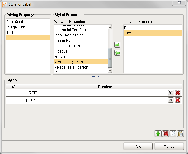

I must not understand what you mean. See this screenshot of using the styles feature for text and font style:
 ![](https://us1.discourse-cdn.com/inductiveautomation/original/1X/e53b41fc4f25b5b6492493956db972e70eb6a916.PNG)

Also - styles are stored as dataSets in the expert properties. You can copy and paste these between components.

_and_ you can store project-wide styles in dataset client tags and bind to those.
