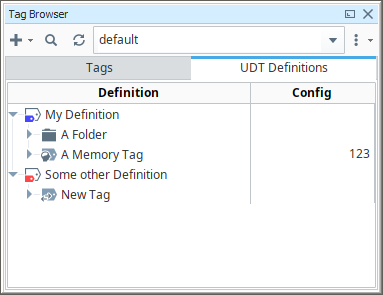

Be subtle, man. Be subtle! I'd go with just changing the icon.
 ![img1-4bc0c3b97964c7ae2046decfbddec375](https://us1.discourse-cdn.com/inductiveautomation/original/3X/2/f/2fb6e5e457e87c12c8e0d04afd94acb194fc3564.png)
For example, the UDT editor allows one to apply a color to the UDT. It's very small but it's instantly recognisable, very helpful and maintains a very clean user interface.
Use color carefully, consistently and with purpose. In general using primary colors like `#ff0000` (red) and `#0000ff` (blue) can look amateurish. Define some theme colors instead and use those or use the [Perspective Built-In Themes | Ignition User Manual](https://docs.inductiveautomation.com/docs/8.1/ignition-modules/perspective/styles/perspective-built-in-themes#built-in-theme-colors) instead. Note that none of those use `ff` values in the red, green or blue channels. Name your styles with something that describes what you are trying to convey rather than the color. e.g., "Error", rather than "Red". Doing it this way means you can change the theme without having to edit all your scripts, and bindings, etc.
