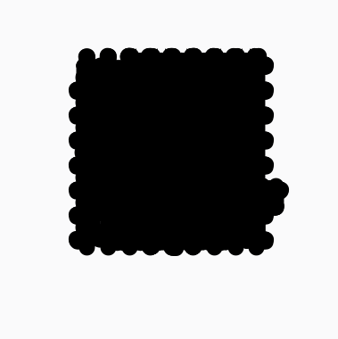

I am trying to import an SVG into Vision however I keep getting this weird bug where it makes it a blob. Any suggestions on how to fix this?
How it should look:
 ![image](https://us1.discourse-cdn.com/inductiveautomation/original/3X/5/c/5c24dc36fc01593e1ae9b05cab82245140aa9d94.png)
What I get:
 ![image](https://us1.discourse-cdn.com/inductiveautomation/original/3X/a/9/a9797599d1670e82e998221dd17e642a9c9cce6d.png)
**Post date:** [April 26, 2021, 8:24pm UTC](https://forum.inductiveautomation.com/t/svg-import-error-big-black-blob/46042/2 "2021-04-26T20:24:29Z")
Have you checked the stroke widths of the imported lines?
If in Inkscape, try explicitly setting all line strokes to a value and then saving your SVG as an optimised SVG
**Author:** ![alec](https://sea1.discourse-cdn.com/inductiveautomation/user_avatar/forum.inductiveautomation.com/alec/32/41994_2.png) [@alec](https://forum.inductiveautomation.com/u/alec)\
**Post date:** [April 26, 2021, 9:05pm UTC](https://forum.inductiveautomation.com/t/svg-import-error-big-black-blob/46042/3 "2021-04-26T21:05:31Z")
Thank you, this worked!

Is there a quick way to explicitly set all stroke widths, ideally without "changing" anything about the image?
Thanks!
