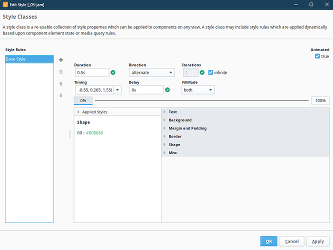

Here's an example. The red section on the left is about a pixel shorter than the one on the right, yet, here's the element for the one on the left:
 ![image](https://us1.discourse-cdn.com/inductiveautomation/original/3X/9/f/9f30d9500f7cc7d18840a236152c004536fedc23.png)
Here's the one on the right:
 ![image](https://us1.discourse-cdn.com/inductiveautomation/original/3X/6/2/62c6b5d60e6a3a64d358cc477067966fd1968166.png)
The ONLY difference between the two is the style classes.
 ![image](https://us1.discourse-cdn.com/inductiveautomation/original/3X/6/4/6420e70915ef3f59a23d4d53e52cd132ad064a6b.png)
 ![image](https://us1.discourse-cdn.com/inductiveautomation/original/3X/7/a/7a90a7cfeac41ce41776321784d7741ab58db6cd.png)
