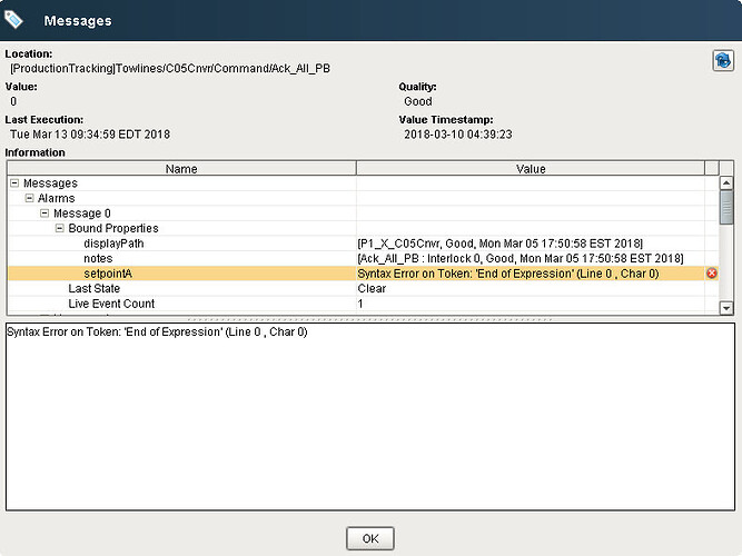

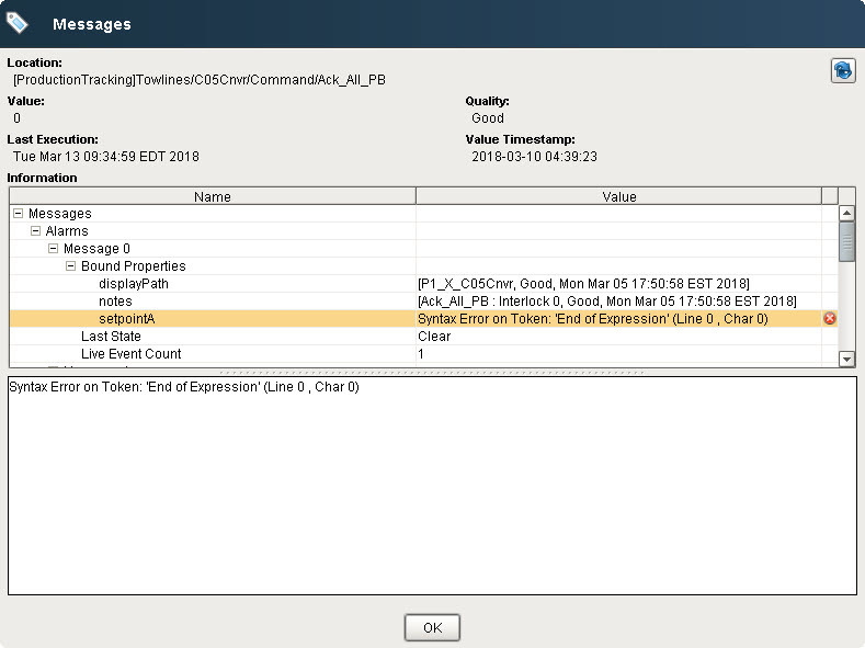

I have configured some alarms on an integer using Bit State alarm mode. But the Tag Diagnostic window show me the error “Syntax Error on Token: ‘End of Expression’ (Line 0 , Char 0)” for the “setpointA” on “Bound Properties” of the Alarm.
I have made the same thing like the online tutorial and i don’t understand what I made wrong.
Thanks
 ![](https://us1.discourse-cdn.com/inductiveautomation/original/2X/7/7f9800124a233e46849fe1d538042be0dce6a5cf.jpg)

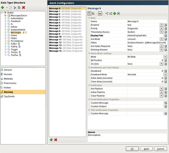

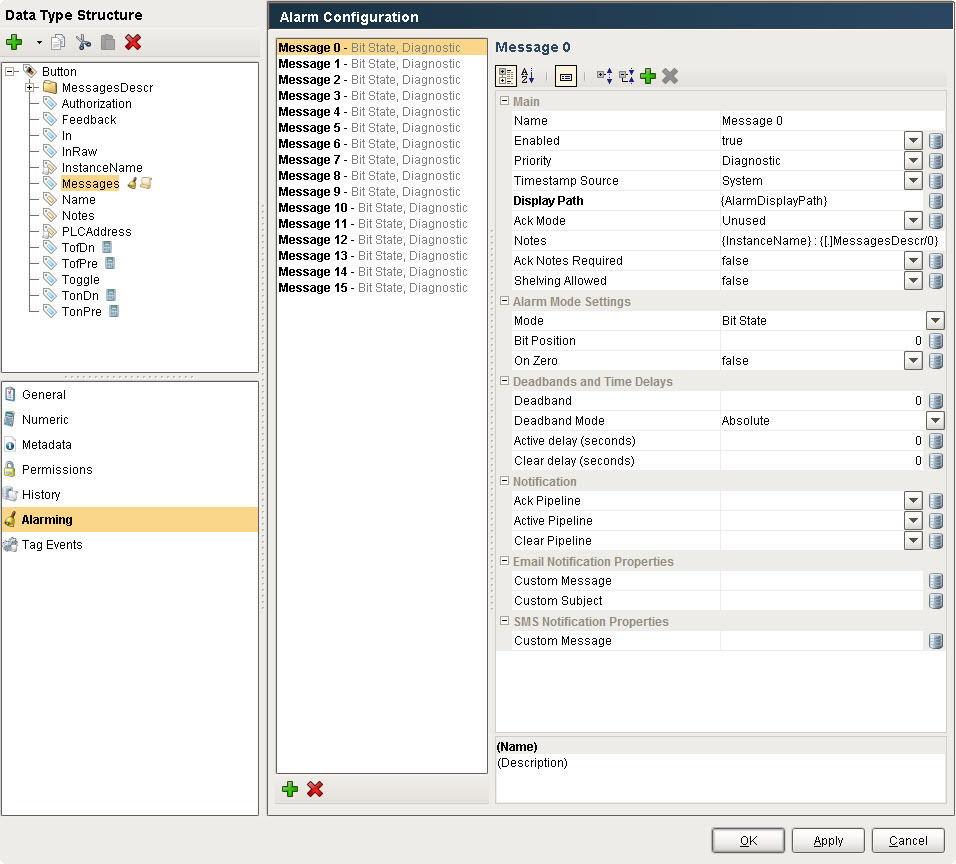

This is the UDT definition
 ![](https://us1.discourse-cdn.com/inductiveautomation/original/2X/a/a5ac1e309aa2f70843ca9067e217e59070cf68bf.jpg)

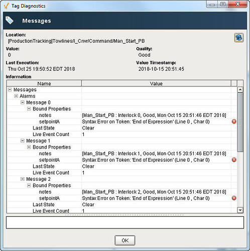

This is the Tag Diagnostics of 1 instance of UDT
 ![](https://us1.discourse-cdn.com/inductiveautomation/original/2X/8/8dfa2f0af6879c57b3f0391bf727080aa2a8c3c4.jpg)

**Author:** ![MMaynard](https://sea1.discourse-cdn.com/inductiveautomation/user_avatar/forum.inductiveautomation.com/mmaynard/32/3366_2.png) [@MMaynard](https://forum.inductiveautomation.com/u/MMaynard)\
**Post date:** [October 26, 2018, 12:19pm UTC](https://forum.inductiveautomation.com/t/syntax-error-on-token-for-setpointa-on-bitstate-alarm-mode/17341/9 "2018-10-26T12:19:12Z")
Put single quotes around {AlarmDisplayPath} on the Display Path Binding.
> '{AlarmDisplayPath}'
**Author:** ![EricProvBRP](https://sea1.discourse-cdn.com/inductiveautomation/user_avatar/forum.inductiveautomation.com/ericprovbrp/32/6352_2.png) [@EricProvBRP](https://forum.inductiveautomation.com/u/EricProvBRP)\
**Post date:** [October 29, 2018, 2:54pm UTC](https://forum.inductiveautomation.com/t/syntax-error-on-token-for-setpointa-on-bitstate-alarm-mode/17341/10 "2018-10-29T14:54:32Z")
Thank for you answer, but it doesn’t erase the error
**Post date:** [October 29, 2018, 3:48pm UTC](https://forum.inductiveautomation.com/t/syntax-error-on-token-for-setpointa-on-bitstate-alarm-mode/17341/11 "2018-10-29T15:48:14Z")
I opened your UDT and it appears that the line for SetPointA is blank on all of the alarms but it is bound to an expression type. I would try removing that line from the UDT and reimporting it.
