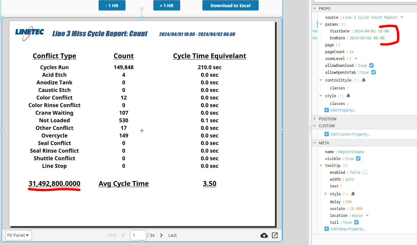

so I have a script that does some simple conversions in a perspective report. I look for the seconds between 2 date/times that i have parsed from a string(I know I know). In the standard report to time works great. there are 64,800 seconds in a 18hr period...
I then take that report and create a perspective view and pull in the date/times I want from a couple variables. but when I put in anything that crosses midnight it blows up. instead of 64,800 sec, I get 31million seconds. The date/time formats are all the same otherwise it wont work(another issues I figured out earlier). what is happening.
This is a good picture... date is from 4/1 at 6PM to 4/2 at 6AM
 ![image](https://us1.discourse-cdn.com/inductiveautomation/original/3X/3/c/3ca7fb7e9eabca9bc6fac04beab1694fbfc6a559.png)
This is what shows up... any thoughts?
 ![image](https://us1.discourse-cdn.com/inductiveautomation/original/3X/0/4/0428001f4a9bc7627f350b82f97ea0afc7f7a2a5.png)
**Author:** ![Ben\_Blaschuk](https://avatars.discourse-cdn.com/v4/letter/b/5daacb/32.png) [@Ben\_Blaschuk](https://forum.inductiveautomation.com/u/Ben_Blaschuk)\
**Post date:** [April 2, 2024, 9:25pm UTC](https://forum.inductiveautomation.com/t/system-date-between-oddity/88261/2 "2024-04-02T21:25:38Z")
Never Mind... I figured it out... it was the format of the date it self... it did not like the yyyy/MM/dd and finding the difference over midnight. as soon as I change it from yyyy/MM/dd to MM/dd/yyyy... all was happy again...

**Post date:** [April 2, 2024, 11:39pm UTC](https://forum.inductiveautomation.com/t/system-date-between-oddity/88261/4 "2024-04-02T23:39:06Z")
_Pssst!_ Also, it is 86,400 seconds per UTC day. Just in case that was throwing you off, too.
**Post date:** [April 3, 2024, 4:16pm UTC](https://forum.inductiveautomation.com/t/system-date-between-oddity/88261/5 "2024-04-03T16:16:26Z")
there are 64800sec in 18 hours.. which was the time frame of the report. corrected the 12 v 18 in the post above.
