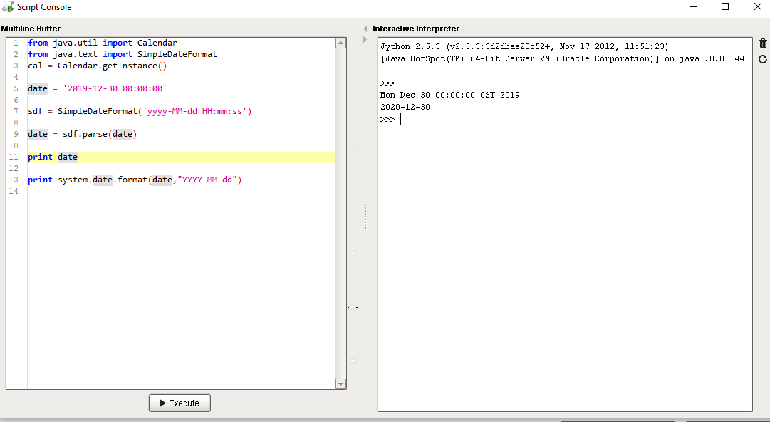

I found something Strange,
I have a date Mon Dec 30 00:00:00 CST 2019
when I tried converting this to `system.date.format(date,"YYYY-MM-dd")'` it gave me
```auto
2020-12-30
Here,
 ![image](https://us1.discourse-cdn.com/inductiveautomation/original/2X/5/534ea858ccbc5b38b5e216132665a8f2911471b7.png)
The year is completely different !

YYYY is “week year”, which is almost never what you want.
You need yyyy.
(See Paul’s video for why, or [this SO question](https://stackoverflow.com/questions/34691582/how-does-java-week-year-really-work).)

wow, sometime you feel you’re smart but then someone comes in and tells you how dumb you’re !! Thanks so much
