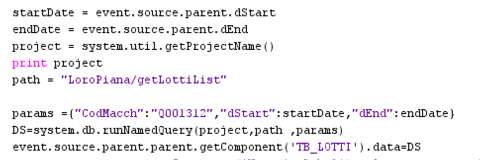

I’m using this function on Designer and it works. When I save the project and start the client it won’t work.

This is the code in a script :
 ![img1](https://us1.discourse-cdn.com/inductiveautomation/original/2X/3/320c660d59834944bf1265de1fa52812c3fc15da.png)

If executed in the Designer it works perfectly, but after saved the project and published, the query won’t be executed leaving an error message as below:
Traceback (most recent call last):
File “event:actionPerformed”, line 10, in
com.inductiveautomation.ignition.client.gateway\_interface.GatewayException: com.inductiveautomation.ignition.client.gateway\_interface.GatewayException: Named query LoroPiana/getLottiList not found
caused by GatewayException: Named query LoroPiana/getLottiList not found
caused by GatewayFunctionException: Named query LoroPiana/getLottiList not found
Ignition v7.9.13 (b2019120915)
Java: Oracle Corporation 1.8.0\_251

**Author:** ![roberto.buompane](https://avatars.discourse-cdn.com/v4/letter/r/dec6dc/32.png) [@roberto.buompane](https://forum.inductiveautomation.com/u/roberto.buompane)\
**Post date:** [May 13, 2020, 8:50pm UTC](https://forum.inductiveautomation.com/t/system-db-runnamedquery-problem-on-client/34709/10 "2020-05-13T20:50:44Z")
I’ve tried this :
 ![image](https://us1.discourse-cdn.com/inductiveautomation/original/2X/d/d546a8cccbf8e762f61b83e6345bb319aadecb81.png)
but it doesn’t work
this is the error :
java.lang.ClassCastException: java.lang.ClassCastException: Cannot coerce value ‘LoroPiana/getLottiList’ into type: interface java.util.Map
caused by ClassCastException: Cannot coerce value 'LoroPiana/getLottiList' into type: interface java.util.Map

OK so think that error is _caused_ by adding the project name.
Where/how are you calling the script?
Fix the G regardless
**Post date:** [May 13, 2020, 9:11pm UTC](https://forum.inductiveautomation.com/t/system-db-runnamedquery-problem-on-client/34709/13 "2020-05-13T21:11:22Z")
Solved!!!
A very stupid error but strange behavior:
I named the query getLottiList but I wrote GetLottiList in the function; in Designer worked fine but not in the client.
Thanks a lot Matrix\_Engineering!!
