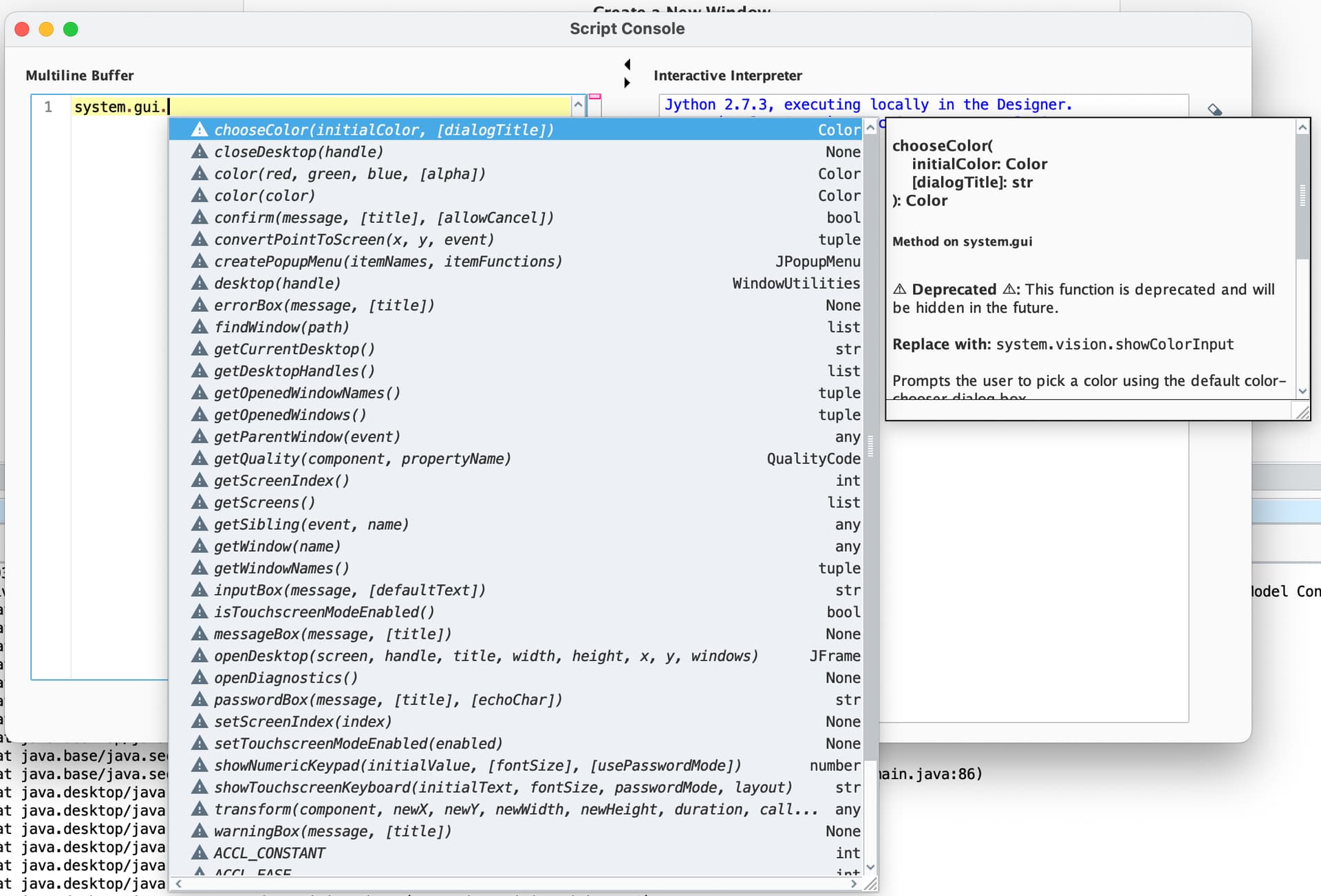

Hi!
I'm using system.gui.confirm() in a scripting code that is executed via the scripting console.
How could I do that now?
Thx!
**Post date:** [October 14, 2025, 2:30pm UTC](https://forum.inductiveautomation.com/t/system-gui-dissapears-in-8-3-what-is-its-equivalent/111439/2 "2025-10-14T14:30:56Z")
It still exists for backwards compatibility, but is deprecated (and hidden from autocomplete).
Its replacement is `system.vision.showConfirm()`: [system.vision.showConfirm | Ignition User Manual](https://docs.inductiveautomation.com/docs/8.3/appendix/scripting-functions/system-vision/system-vision-showConfirm)

`system.gui` and `system.nav` will still be visible as long as you're in a script editor with designer scoped autocomplete. Such as the script console:
 ![image](https://us1.discourse-cdn.com/inductiveautomation/original/3X/8/1/810d6ff8161792262cbc3851038c615d4319b82a.jpeg)
The vast majority of the functions marked as deprecated in 8.3 are "soft" deprecated in this way - they're deemphasized in autocomplete and the popup guides you to the replacement function.
It's worth noting that there's zero urgency to migrate. Just because the function is deprecated does not mean we have any plans to break it, intentionally or unintentionally. We have a strict backwards compatibility policy for our scripting functions.
