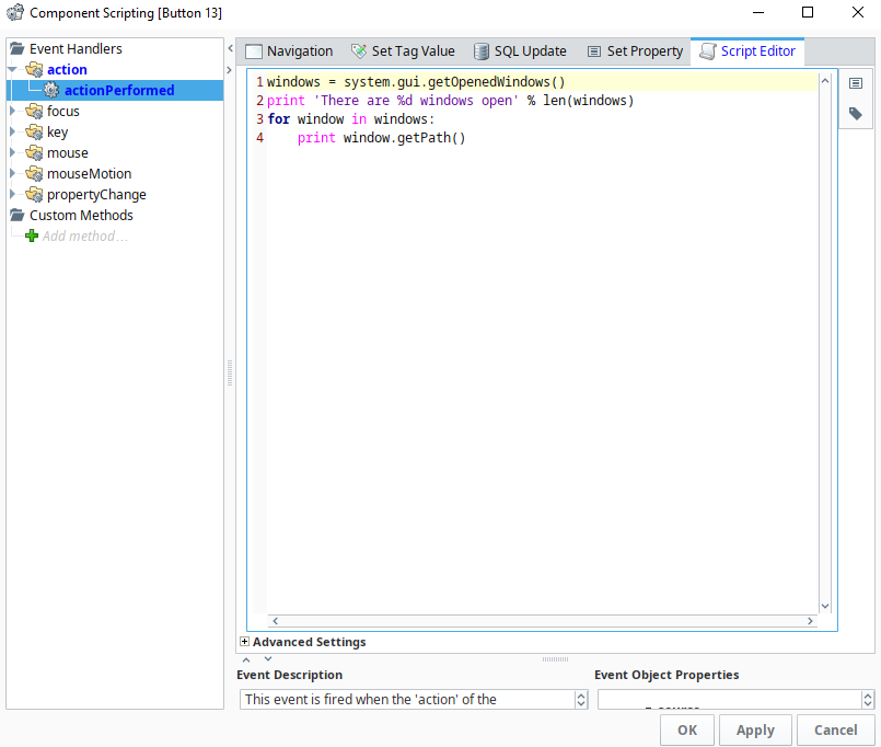

Hello everybody! I’d like to know why I see an empty tuple by running the following code:
 ![Cattura](https://us1.discourse-cdn.com/inductiveautomation/original/2X/4/4a54c939e51bbdc7f879ca1704cbfeb3a9520dcb.png) .
(I want to clarify that I ran the code with some windows open).
Thank you all!
**Post date:** [January 23, 2020, 6:02pm UTC](https://forum.inductiveautomation.com/t/system-gui-getopenedwindownames/31547/2 "2020-01-23T18:02:29Z")
`getOpenedWindows` returns an empty list in the designer. Is it still empty in an actual client?
**Author:** ![andrews](https://avatars.discourse-cdn.com/v4/letter/a/898d66/32.png) [@andrews](https://forum.inductiveautomation.com/u/andrews)\
**Post date:** [December 8, 2021, 9:07pm UTC](https://forum.inductiveautomation.com/t/system-gui-getopenedwindownames/31547/3 "2021-12-08T21:07:38Z")
@paul-griffith how would I run that in the actual client? the client does not seem to have a scripting console
**Post date:** [December 8, 2021, 9:14pm UTC](https://forum.inductiveautomation.com/t/system-gui-getopenedwindownames/31547/4 "2021-12-08T21:14:18Z")
Put the script in a button’s `actionPerformed` and `print` the result. Then open the client diagnostics (Ctrl + Shift + F7, if the menubar is disabled) and check the console.
