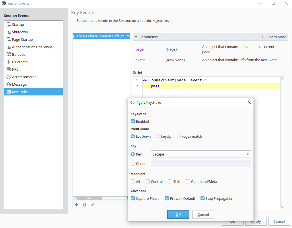

Is there a way to prevent a pop up opened via the system.perspective.openPopup function from being closed by an operator pressing the escape key?
**Author:** ![dkhayes117](https://sea1.discourse-cdn.com/inductiveautomation/user_avatar/forum.inductiveautomation.com/dkhayes117/32/68344_2.png) [@dkhayes117](https://forum.inductiveautomation.com/u/dkhayes117)\
**Post date:** [June 5, 2025, 6:59pm UTC](https://forum.inductiveautomation.com/t/system-perspective-openpopup-question/107105/2 "2025-06-05T18:59:15Z")
You can do this by blocking the escape button completely, meaning it doesn't work within perspective on anything, not just popups.
Project Session Events → Keystroke → Enable all Advanced features → `pass` inside script
 ![image](https://us1.discourse-cdn.com/inductiveautomation/original/3X/d/5/d55a80d16e3d17aac6cfb4377ae3288bac4f4662.png)
